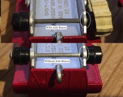

Just going through a few recent additions which included the Snow Trac without axle braces, luckily I had one with braces as well and noticed the model without braces is wider at the back behind the wheels. To me this seems the wrong way around, unless for some reason they made this area narrower and added axle braces.

Even after studying the composite photograph, I don't understand what you mean. However, we do know that the back panel was retooled, first to eliminate the windows either side of the door, and then again to eliminate the ghostly outlines of those windows.

No, still don't see it. Sorry.
If you look at the positioning of the (for want of a better tern) "chassis rails" where they meet the rear skirt, there's no difference.

Hi, should have added these to show what I was on a about.

nearlymint wrote:Hi, should have added these to show what I was on a about.
Yes, you should have!
(I was looking at the width
between the "chassis rails", an impression reinforced by Ghosty's arrows which seemingly indicated 'look at the width of the gap'.)
Isn't that odd? That's a major retooling since there's less metal on the outside in the webbed casting than there is original version. Something to do with how well the tracks stayed on perhaps?

All of mine, with and without braces, have the thicker part of the chassis rail, which is actually a ring on the rail behind the wheel - here shown on the first version without braces but it’s the same with the braces.
Jason, does your thin rail version have this ring? Perhaps the original mould had to be replaced in the 5 years the Snow Trac was in production? Which variation is it?
Does anyone else think the braces on this model are an entirely pointless modification? They really can’t add much -or any - strength.

Thanks for the reply, I will dig my others out and see if any others are thin like this one.

After checking a few others, I think as Glen has said its the boss behind the wheel thats missing making it look narrow. I have another one that looks even narrower and both have the name cast in which is towards the end of the models life.
