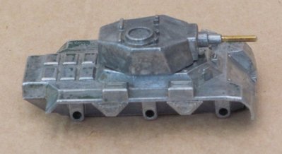

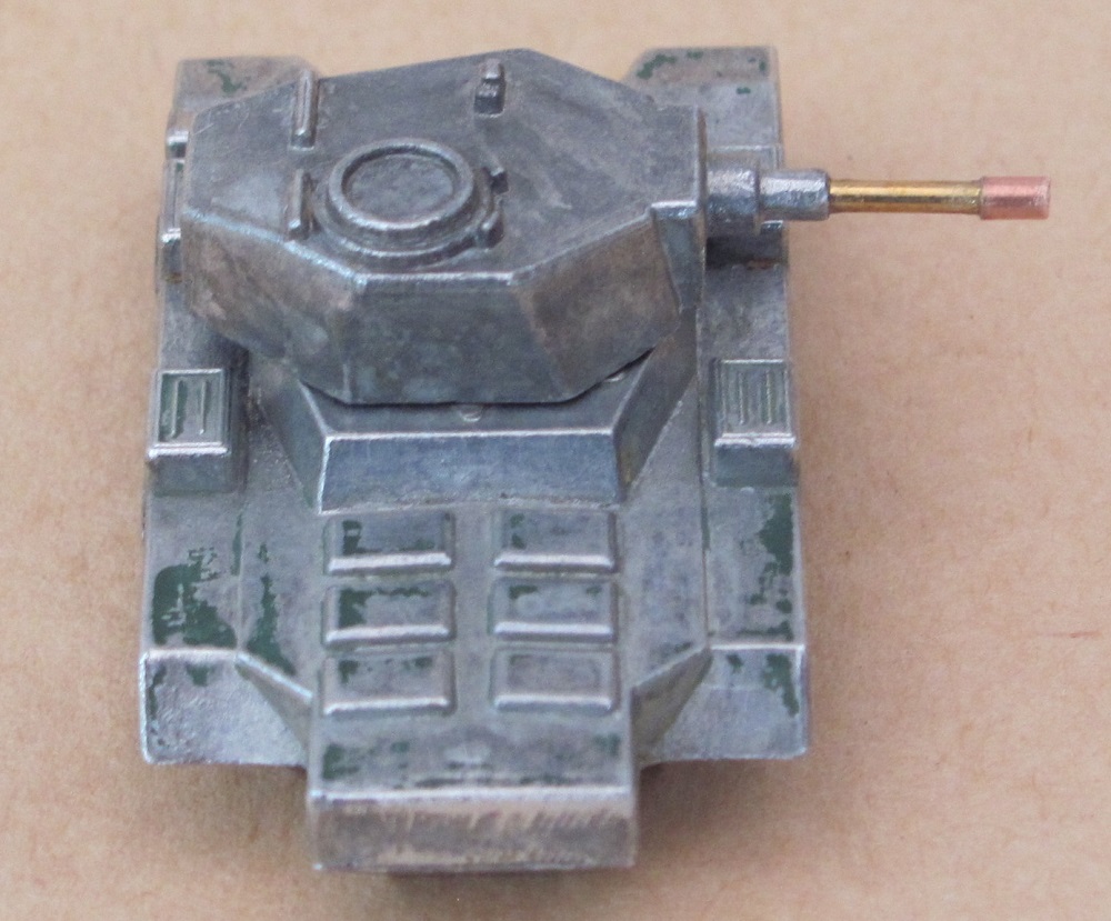

I have a few beaters on the bench at the moment.
A Matchbox Saladin missing its gun barrel and a broken wheel.
The gun barrel was easy enough to fix ...
I drilled into the stub, added a length of brass rod and then sweated on a short length of copper tube reamed out to within a gnats whisker.
I think that I'll repaint it into desert sand then hopefully I can buy a nice drab green example to display it with.
The half wheel may have to stay on the blind side of the display case as the wheels have a moulded in spacer.
Maybe a normal wheel suitably spaced would work.
Re: AJR's Customs
Posted: Fri Sep 25, 2020 7:50 am
by Tinman
AJR wrote:The half wheel may have to stay on the blind side of the display case as the wheels have a moulded in spacer.
Very nice job on the barrel! I've done several that had broken wheels (and one with no wheels) by making small spacers that fit over the axles and using a common wheel of the correct size and tread count.
