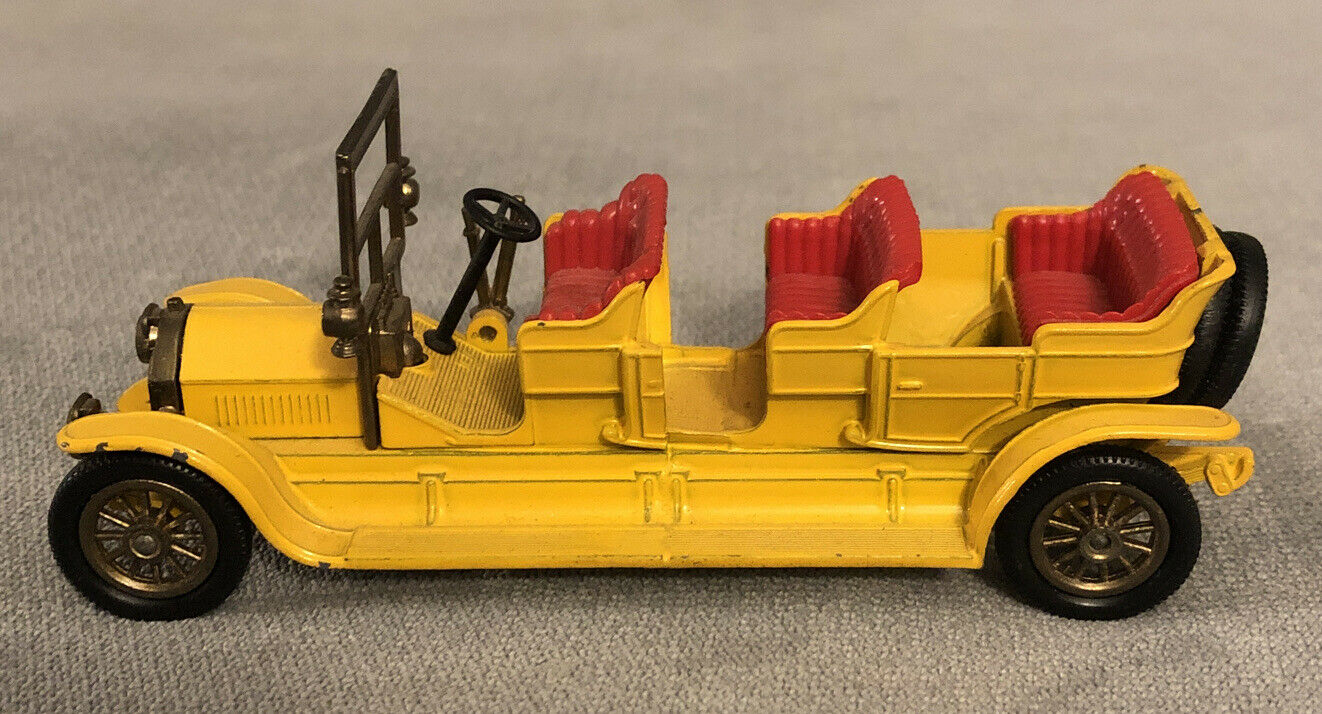

This model recently sold on E-Bay for $100+
Described thus.
Vintage Lesney Matchbox models of yesteryear Y-5 1907 Peugeot Limo? Modified? Factory Mishap? Unlisted variation? W/Box. This is a really awesome and different lesney models of testeryesr 1907 Peugeot. The car has 3 seats instead if two. It measures approx 4.5 inches long. If someone did modify this they did an amazing job.

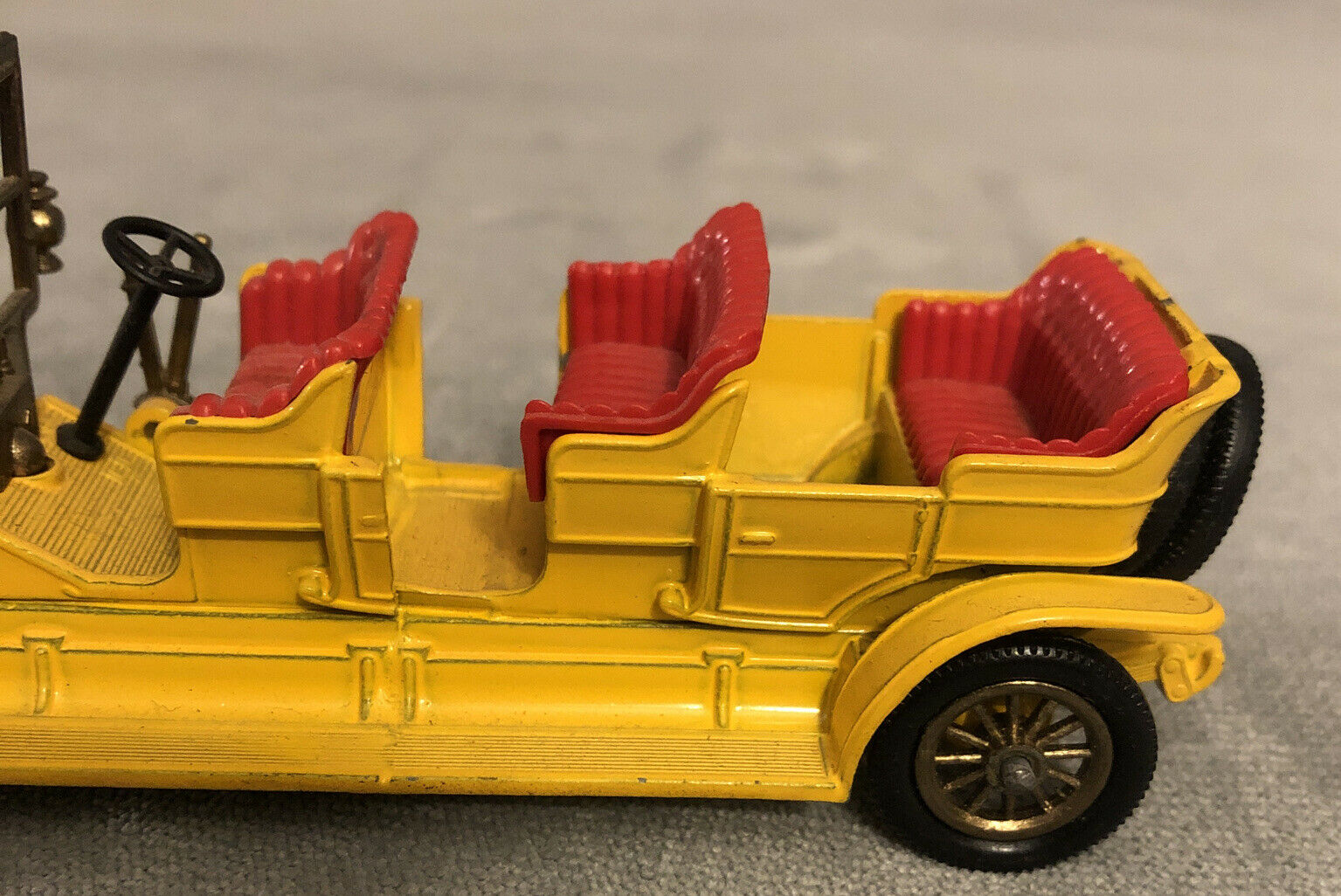

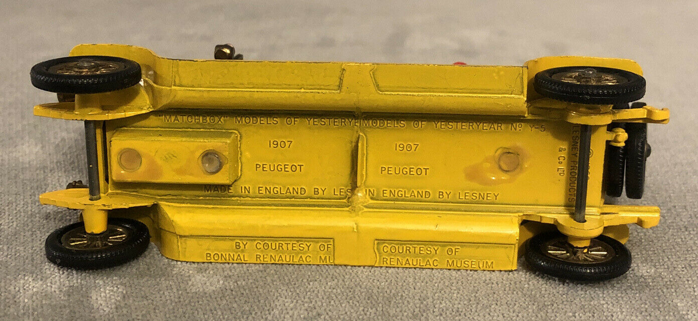

To me, it looks like a modern day "cut & shut". The castings are normal production, not prepro or early, and prototypes of this era, if made from two cut bases, are usually joined by two riveted fillets. How have these been joined? JB Weld? Surely a proper company R&D model maker would do a better job than just hacksawing through the seats? The roof attachment lugs on screen and body have been removed.
