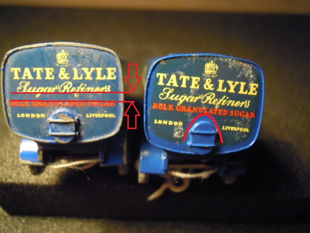

Re: 10c Foden Sugar Container Truck
The decal with crown is different also
- DSCN6060.JPG (23.24 KiB) Viewed 2667 times

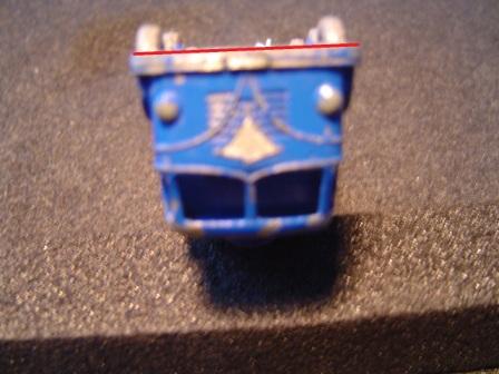

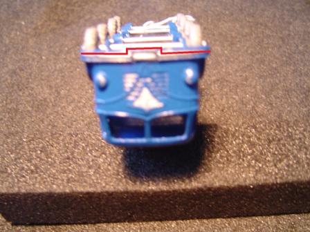

The front clip slot is without strengthening brace or step (similar to 46a tan Morris) and the front clip is bigger (typically all models have front clip slot with strengthening brace)
- DSC00145a.JPG (25.66 KiB) Viewed 2666 times
- DSC00140a.JPG (30.19 KiB) Viewed 2666 times

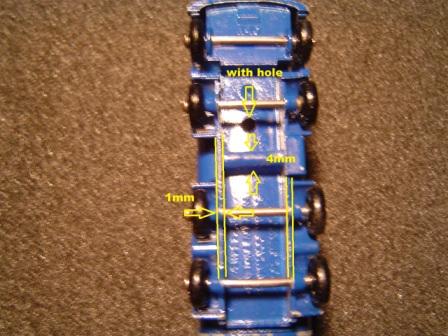

I have mentioned five years ago another unlisted variation, sometithing between chassis A and B: chassis 1mm wide (continuosly), 4mm brace, with hole and BPW ø9x24
- DSC00150a.JPG (34.81 KiB) Viewed 2666 times

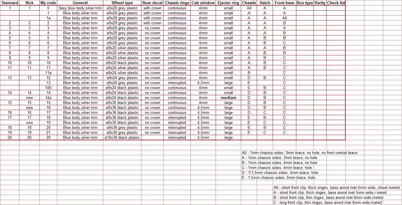

I am enclosing the proposal of a new 10c list. Please comment
- 10c Suger Container Truck.jpg (558.39 KiB) Viewed 2666 times
Not sure what you mean, Antonin. Could you please explain?Diecast wrote:The decal with crown is different also
I think that the cut off was enlarged and the red text was moved up.Idris wrote:Not sure what you mean, Antonin. Could you please explain?Diecast wrote:The decal with crown is different also
- DSCN6085.JPG (93.48 KiB) Viewed 2567 times

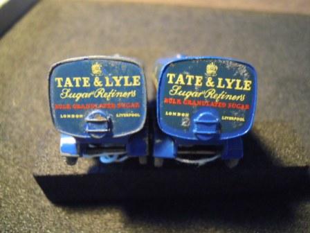

I think what we are looking at is a mis registered decal. It consists of just Two colours with possily the Yellow being laid down first then they are run through the machine again to have the Red laid down. It seems as if the model on the right has a badly printed decal where the red is not in the same position as the decal on the other model.
It is the decal on the left model that looks evenly printed.
I think I'd be happy to accept the size of the cut-out as a variation, but not the relative positions of the red and yellow text. As Ghosty points out, this could easily be the result of simple mis-registration during printing.Diecast wrote:I think that the cut off was enlarged and the red text was moved up.Idris wrote:Not sure what you mean, Antonin. Could you please explain?Diecast wrote:The decal with crown is different also
