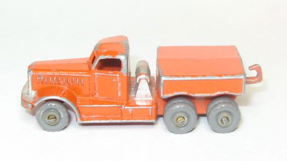

I recently won this item

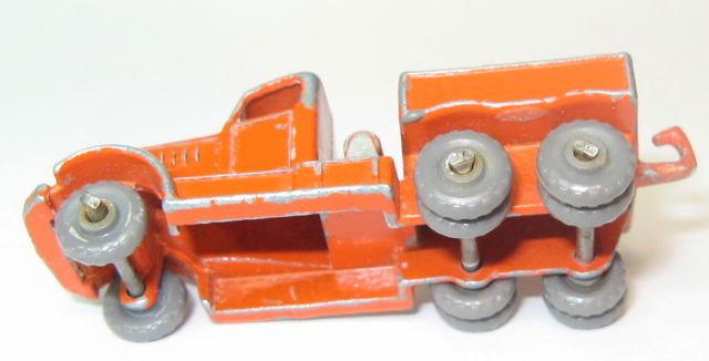

When I inspected it I noticed that the crimping was really close to the hubs
Another one I have has much longer axles and clear separation between crimp & hub

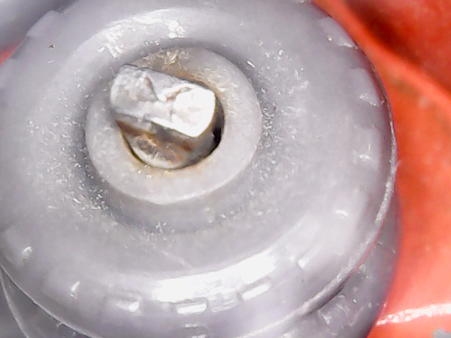

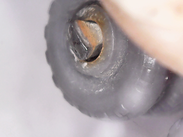

My initial thought was that perhaps the plastic wheels had been forced over the crimped axles but inspection under digital microscope shows no sign of plastic stress fractures, hole widening and the wheels do not slide over the crimped axle ends.
Can't figure out how they could have crimped the axle ends on such short axles without damaging the wheels (unless the plastic wheels have expanded over time).
Welcome any suggestions - bet it will be something obvious, and yes I did push the other end in as far as possible :D
