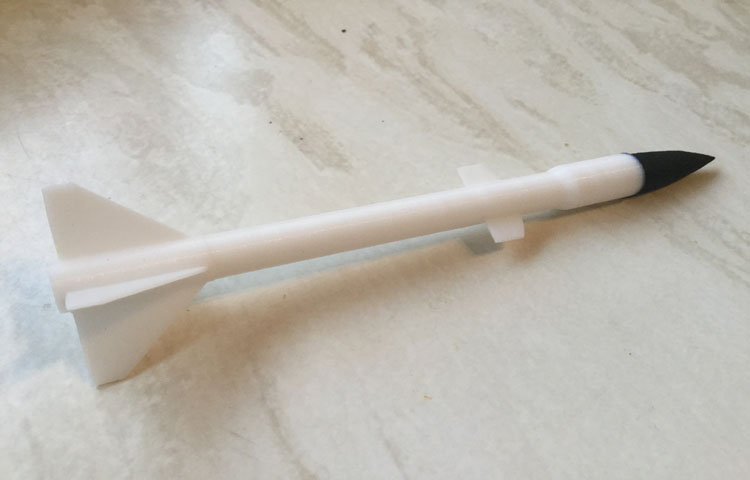

OK well as this has got a little bit of interest I'll comment of the project.
I have attached two pictures one on the finished missile and the other the cad software I use.
Yes I do have a 3D printer and get a lot of fun from it. But don't think this is just a plug and go exercise far from it.
Although it's been around for some years now there's still a lot of experimenting with it. For the cad drawing I use 3ds Max
but it's your preference as there is a lot of software out there some of which take a lot of getting into.
Anyway see what you think Google is your friend and a lot of patience goes a long way

Looks good to me as a modern Day replacement. Be interesting to know what the texture of the surface is like when fully finished or if no further attention is need and the picture shows it as finished. Any chance of a close up of just a section of the rocket, thank's.

Yes there is - thanks for your answers.
4D2D wrote:Yes I do have a 3D printer and get a lot of fun from it. But don't think this is just a plug and go exercise far from it.
What kind of Printer is it?
Do you have the possibility to print in two ore even more colours at once ore is the top of the rocket painted or a seperate part?

Here's a picture of the missile close up cameras not too good at close range but you will see the ringing of each layer of the print as it builds up
On this print the resolution on the print file was set 0.04 mil in the slicer print software could go a little better but with that small amount your not going to
see much difference. At this setting total print time is 4 hours and that's on a small item like this.
To the other questions asked my printer is a Original Prusa MK2 quite an amazing machine as good as some of the machines costing well over thousand pounds.
This machine can print in 2 colours and even 4 colours if you have the add on attachment for the machine. In the machines firmware you have an option now to stop the print
change the colour and resume printing.
