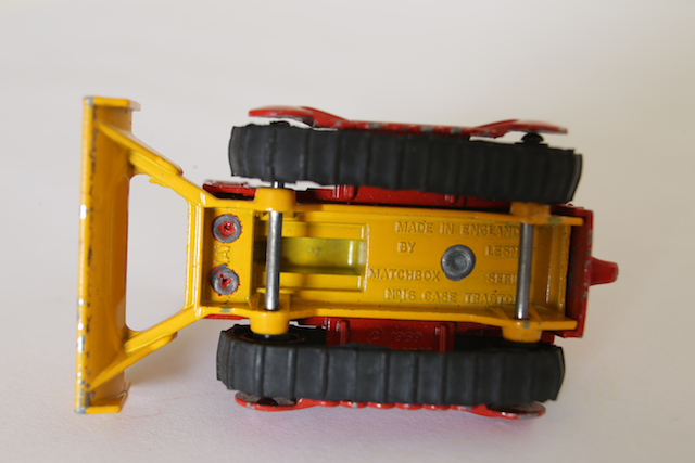

16d base 4 no quotes
I have base 4 without quotation marks around Matchbox. Mine also has black tracks with 26 treads, not the 25 of the green tracks, though there's no way of telling whether they've been replaced. The hook is on a beam, there are no cab "ears", the track guards are squared and the bulldozer blade is without a ridge and has rounded inner corners.
I think the quotation marks must have been added early (perhaps very early?) in production when someone remembered that they form part of the trademark. If so, there should also be base 3 without quotation marks, and base 1 with them.

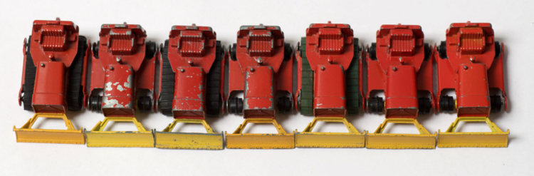

The body colour started in a darkish red, then became darker, and finally ended up in an orange-red. It's hard to see here, but you can see it best in the darker seats of the 2nd to 4th models below.
body colours - oldest on left.
The orange-red has a yellow undercoat which is very close to the colour of the base. This has been noted before.
yellow undercoat
yellow undercoat
The base colour started in a yellow-orange, but changed to yellow before returning to a slightly lighter shade of yellow-orange on the last 16ds.
base colour
base colour

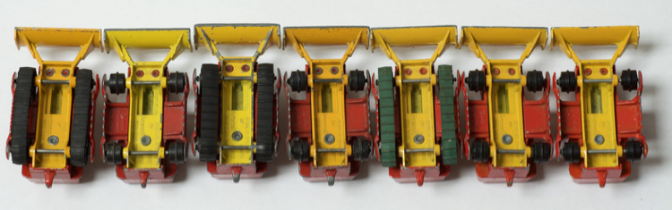

Next, casting differences. There were definitely 4 different bases, helpfully numbered 1 to 4. I think all four were in production throughout the run of the 16d. I think this because the "no quotes" base has been shown on bases 1, 2 and 4 and surely must exist on base 3. The "no quotes" base is very early in production and the quotation marks were added very soon. I think the "no quotes" base is rare and very few have been shown here.
There were also different body castings. I think there were probably 4, mainly because it would make sense to have the same number of each in production. This could be wrong, but it's a good starting point.

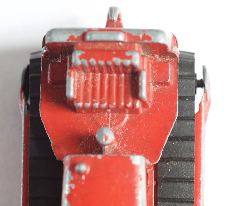

I have one body with a raised semi-circle in front of the driver's seat. This one is easy to spot!
semi-circle in front of driver's seat

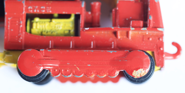

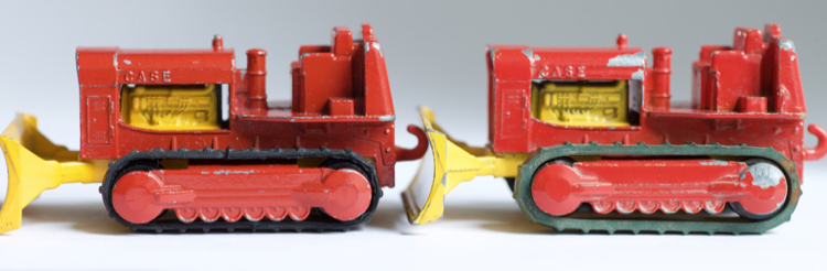

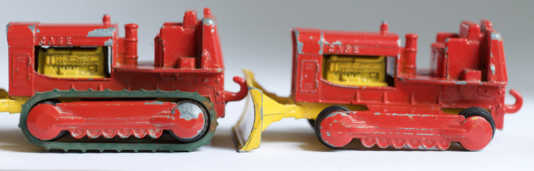

First, the one on the left here. It's on a no quotes base and it's the first casting variation. The top of the track guard is smooth front and rear, in contrast to the 16d next to it which has distinct steps.
track guard castings
The next casting is similar. The 16d on the left is the one on the right in the previous picture, with distinct steps. The one on the right has a similar step at the back but no step at the front and a small hole - though this could be the result of wear on the mould. However, it also has a much more distinct casting line at the front that I think isn't just the paint.

How can we check whether there are four body mouldings? I think that the key is in the early castings, by which I mean the bodies with the beam for the hook, squared track guards and without ears. If you have one of these, it would be good to see a picture of the left track guard and to know if you can see the semi-circle by the seat.
