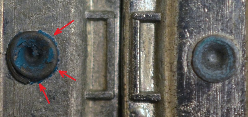

Thank's Greg for the additional pictures.
I agree with Hugh on the colour issue, that could be quite revealing but now I have seen both cars rivets, I am convinced the model does not have factory finish rivets. The front rivet shows indentations around the flare more than the rear rivet does, but more revealing is there are no paint shavings squashed between the underside of the flare and the baseplate immediately under the flare highlighted on the picture below.
Front rivets.jpg (163.09 KiB) Viewed 973 times
What is highlighted in Red is perfectly normal factory finish and the result of the rivet's shaft being a close fit into the baseplate's hole causing the scraping of paint and then bunching up of this paint to become trapped under the rivet's flare when the rivet is pressed or spun down to the baseplate. This is very difficult to fake and this is what I don't see on the mystery Studebaker for both rivets.
