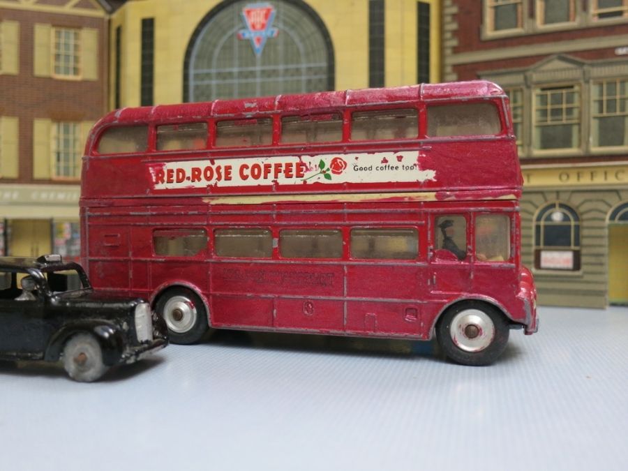

Just purchased this Corgi RM and would love to remove the paint without hurting that very nice unique decals. Would appreciate any help.

This could be a difficult one and we need to try and establish what type of paint has been used, so a few questions for starters...
1, Does it have a gloss or matt finish.
2, Can a finger nail dig into it and scrape away a small area easily.
3, Is the underside also painted the same.
Gloss
No
No

Given your answers, there is a high probability the paint is a common enamel hobby paint. There are a couple of liquids that give similar results, such as nail varnish remover and non synthetic brake fluid.
I do not know what both of these liquids will do to the decal, so it is important you are very careful not to get it on them for now. It is a pitty the base is not painted the same as this would have been a good place to practice some paint removal, so all we can try is one small area perhaps at the back of the Bus.
If you have the means to stand the Bus on it's nose with support from something heavy like a few stone bricks, you can use a cotton bud dipped into some the liquid and concentrate on one area such as one of the panels and keep applying it to keep the area wet.
If you only have nail varnish remover, try this first, it is less troublesome or dangerous than brake fluid if you spill it or get it on your fingers, but in the event of any spillages, kleen it up as soon as you can.
How long the softening will take place depends on how hard the paint has dried and how strong the liquid we are using, thats why we need to keep applying it to the same area in the hope it takes effect and softens the paint, but be prepaired for a long haul because of the subject chosen, a big Bus... :D
After an Hour or so, gently wipe with cloth and gently press a blunt object onto the surface to see if it is soft and to see if with the blunt object you can force some of the paint to move around on the surface, if this is the case then great we have managed to release the paint from the surface.
I said a blunt object such as a handle end of a Tea spoon or a small butter knife as I assume you want to try and keep as much of the original Red paint or are we intending to do a full re-paint, therefore going right down to the bare metal, let me know your intension.
