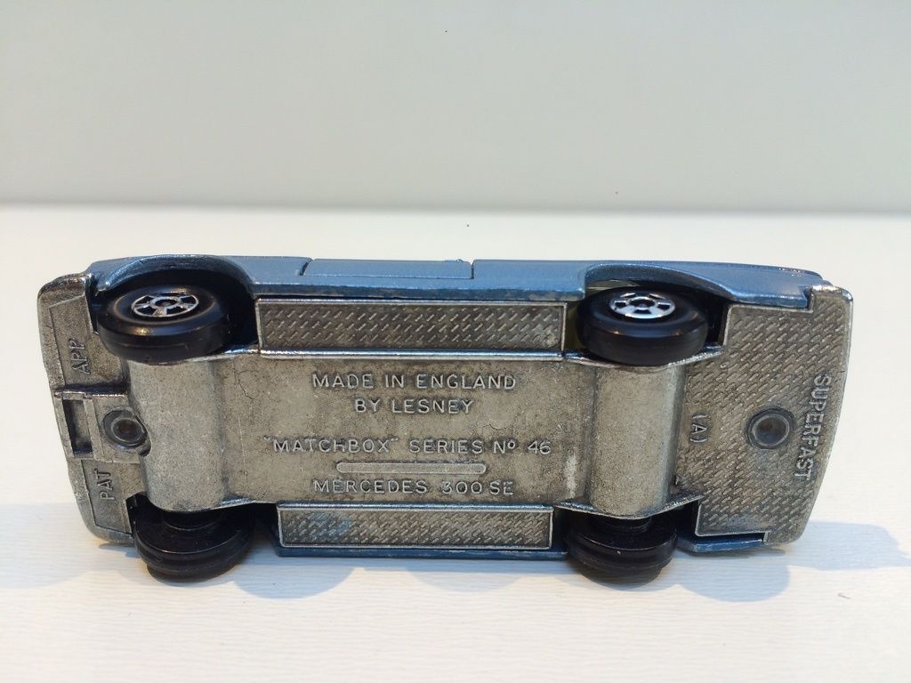

Yes, as Hugh has mentioned, the baseplate is not right, it looks burnished and we have a Mercedes-Benz on the forum with just such a finish coming from an unreliable source...
Bad base!!.JPG (96.87 KiB) Viewed 1403 times
The treatment of this base is something that a plastic kit modeller can achieve for the purpose of adding patina or weathering to Military kits, it does not belong on a Lesney model and appears to have been done to help give the impression of original ageing...!!
To me the Ferrari is the same.
