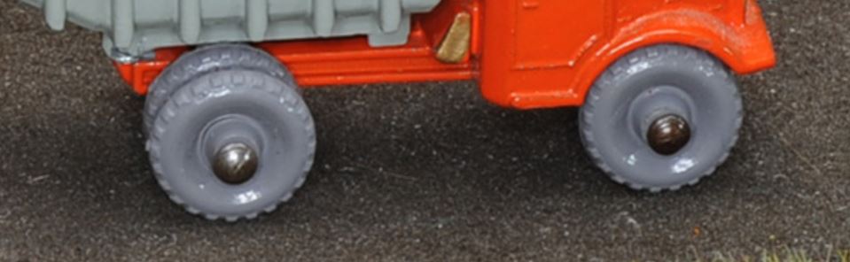

Posted: Wed Oct 14, 2015 7:19 pm
Lesney axle-ends here...!!.JPG (45.57 KiB) Viewed 1405 times
Do these look like Lesney axle-ends, with the strange (for Lesney), central moulding line across the face...!!
Re: German collector/seller ??
Posted: Thu Oct 15, 2015 11:47 am
by Moyboy
They definitely don't look right to me. I have never seen a straight line across rivet ends before. I've seen chunks out and grooving from the centre out but not these type.
