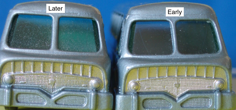

Just adding this slight variation , slightly wider centre pillar in the front windscreen. I have Nick,s code-5,8 and 9 with the later type(wider).
40b
40b

I wonder if that's a deliberate casting variation or simply a detail difference between paired tooling.

To me the whole of the window surround looks a bit thicker and not so sharply cast

Idris wrote:I wonder if that's a deliberate casting variation or simply a detail difference between paired tooling.
Does look to me like they have made it wider, I have about 15 of these and it definitely seems to be more on the later models. I will keep an eye out on earlier models to see if its across all the code,s.
At the moment on my listing,s , I have both types of castings on code 5 but only the wider version on codes 8 and 9.

It rather subtle, but it also looks like the vertical bars in the grill, are slightly wider as well.

One is code 3 (acc. to Nicks list) with narrow and one is code 6 with wider centre pillar.
