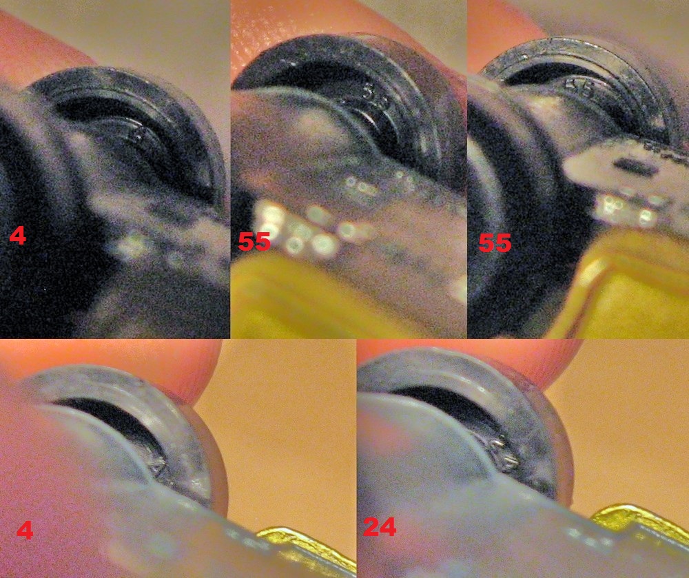

The picture below shows the numbers on the inside surface of the wheels on #29, the Mini in a metallic 'Gold' colour and most of the wheels used on the models have a number, I think I have seen maybe just One or Two wheels that do not have them!

Posted: Sat Mar 21, 2015 5:15 am
by Matchboom
Pictures above are from my gold 29A. I don't think I have explained myself good enough concerning those wheel numbers. I only managed to read (from a series of about 15 awkward macro pics) two numbers from this Mini : A 55 inside front left wheel, and A 24 inside rear right wheel. There is no number 4 (that I can see). If necessary, I may try to capture the two missing numbers on this one. Ruined my eyes last time. Still wondering if info already provided is consistent with 1972 production... Can't wait to see what other castings / variations are going to be analysed here.

Posted: Sat Mar 21, 2015 3:31 pm
Thanks Matchboom, it does look like '4' to me, but if you do re-confirm the numbers I can change the above picture, not a problem.

Posted: Sat Mar 21, 2015 8:51 pm
GHOSTHUNTER wrote:Thanks Matchboom, it does look like '4' to me, but if you do re-confirm the numbers I can change the above picture, not a problem.
I agree it looks like a 4.

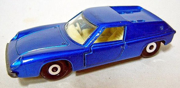

The very earliest type we can see fitted to the models can be seen on this detail images taken from a 1969 Canadian catalogue, shown here.
Three models can easily be seen with early 'Superfast' wheels, the Silver-Grey BMC Pininfarina, the Blue Lotus Europa and the Green Lamborghini and the wheels are clearly of a Black colour with a Silver-Grey central disc which was possibly 'Hot-Foiled' as would be used on full production wheels and it is very likely these wheels are what we class as 'Solid' as again full production wheels were.
I have borrowed this picture from Christian Falkensteiner's site and is a good example of the wheel I mention above.
I do not myself, have any 'Pre-Production' models from this period with these wheels fitted, but I am sure some forum members do, so can I ask those members to offer some pictures of the wheels to this thread, I don't imagine these early models are that hard to find as there must have been quite a number made because they can be found in a number of merchandising material such as adverts and catalogue images similar to the one above.
