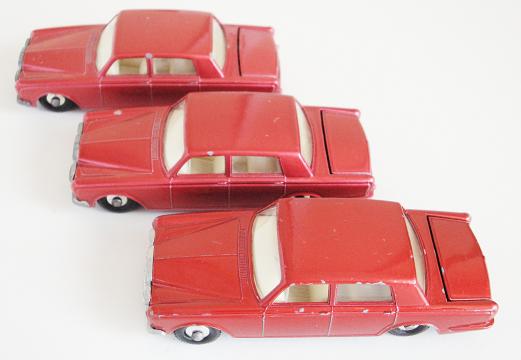

Hello Ghosthunter, here are the four 24c models I have, on Nicks listings from Left to Right codes 2-3-7-9.

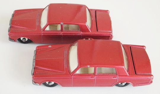

As usual it's difficult showing colour shade differences on electronic viewing equipment, but I think you'll agree the four models shown in the picture posted by "Kerbside" is showing two distinct shades, so I have posted another picture here with 'MY' models 1 and 1A and a later model with the 'Patent' number on it's baseplate (closest to the Camera), to see if you can see how much more of a red colour (what I call 'Cherry Red'), these later models are.
The first model on Nick's code listing with the 'Patent' number is CODE 7, so a few models away from my first two in the same picture.
1, 1A and 'Patent Number' model.JPG (52.41 KiB) Viewed 1746 times

Hello Ghosty, this is a photo I posted on befora showing the red and pinky/red, I can't remember the codes without digging them out but I remember the pinky/red was without the pat number.

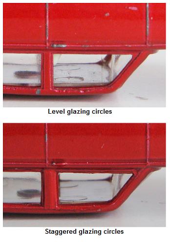

Each "Matchbox" '1-75 Series' model has several ways of identifying which model it is against another seemingly similar model, get enough of them and you can sort them out into a production 'Time-Line'. #24c is no exception, it has casting changes outside (the tow guides at the front), changes inside (the rear wheel-arch brace), the hinge-arm apertures in the boot (two sizes), wheel design (two types), glazing moulding (two types) and base rivet design (small and large). Additional to this are the paint finishes on the baseplate, with gloss black, semi gloss black and matt black. This is an area where each collector may describe a finish slightly different, where I say 'Semi-matt black', to someone else this is probably what they call 'Satin' black and so on.
Nick's Code listing picks up on most of the above, but not the type of glazing moulding, so I have included a picture below showing the two types.
Glazing 'Ejector' circles.jpg (57.39 KiB) Viewed 1700 times
What you are looking at are two 'Ejector' circles moulded into the surface of the glazing component, there are four of these, but the two over the front seats can be 'Level' (in-line with each other), or 'Staggered' (one set further back from the other one), and models with both types seem to be available together through most of the production period of #24c.

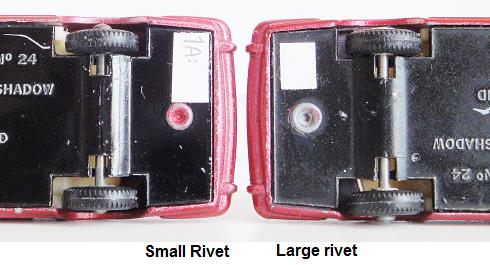

The baseplate rivets are two distinct sizes with the first earlier models having the smaller size, but this did not hold the baseplate as tight as it should have done and the tooling for the rivet post was modified to make the post longer, allowing more metal to be 'Spun-Down' to create a larger diameter head holding the baseplate tighter.
Small and Large rivets.jpg (62.57 KiB) Viewed 1694 times
