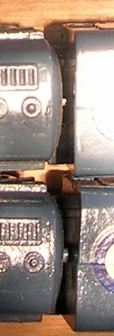

As if that were not enough, there are the trim variations: gold trim to the radiator grille and front bumper (found by a Forum member), silver trim to the front radiator and bumper, silver trim to the rear bumper (I don't know what the front trim is for this variation), and no trim whatsoever.

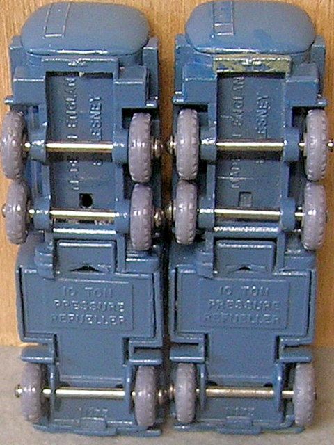

I attempted to update the 71a pressure refueller page but I need to know if the open and closed rectangular hole under the middle axle is common to all 73a's or was the model modified at sometime to open up or close the hole.
Re: 73a Leyland Pressure Refueller

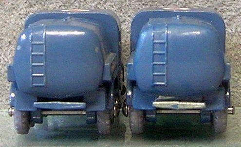

hello Nick more details on the closed rear between the tanks.
1st between the storage cab and the tank on the normal one the brace is a thin flat one, but on the closed rear one this brace is a round one.
2nd the two bases the open hole and the closed hole this is because between the chassis and the tank there is a flat plate cast, so this covers the hole.
In this gap with the eye there is a hole, but on the closed rear version this hole is covered giving rise to the flat plate being cast from here to the rear end making the end section closed, and as you can see the bumper part is Silver trim.
As is the grille on one, the closed rear one is always on the right hand side.
