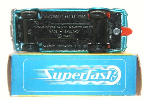

Number 1 body.JPG (32.31 KiB) Viewed 2359 times
Here is a picture from my computer, of the only other 'long seat' moulding model, I was aware of. The sharp edges to the rear bumper cut-out for the tow hook arm, tell me this is a type 1 body casting.
Now "nearlymint" has found a 'long seat' model, that makes three examples we know of so far, hopefully more will be found and by forum members, not just on E-bay, out of reach, but at toy fairs etc.
