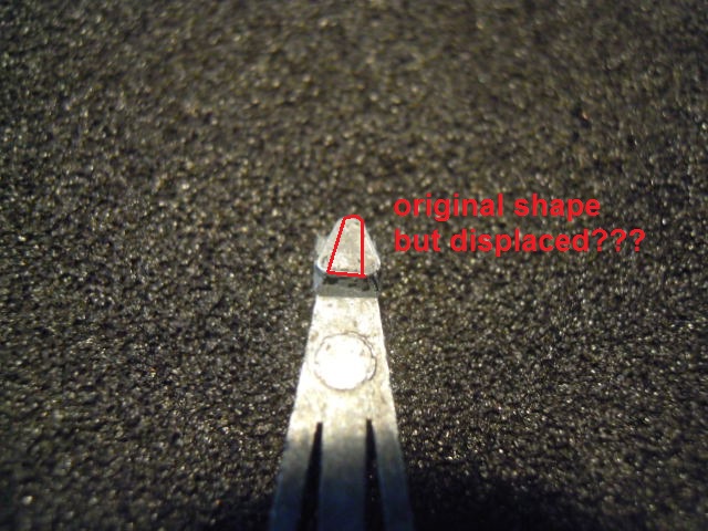

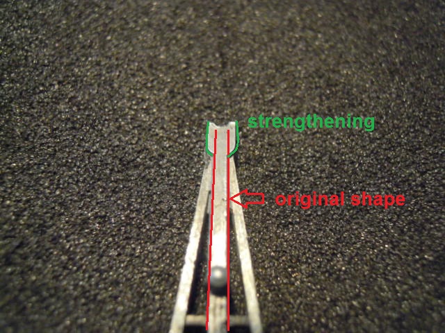

Die that have been repaired, it bears the traces of its original shape. Machine tools left small line at the connection between the old and new shape. When I was examined an old model from my scrap pile, I have noticed the connection lines. On the basis of these lines, I think that the original model was not shorter and it had the towing eye on the same place. Only the original central brace was narrow and there was no side strengthening. On the lower part of the towing eye there had a narrow spade support, but it seems that it was slightly displaced (why????).
- DSCN5505.JPG (134.07 KiB) Viewed 2624 times
- DSCN5506.JPG (125 KiB) Viewed 2624 times

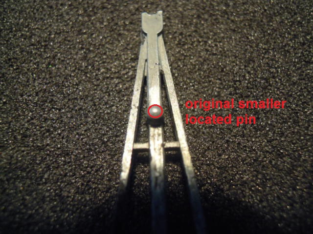

The earlier located pin for the boat was very probably smaller, because there is some trace from the original shape.
- DSCN5507.JPG (128.7 KiB) Viewed 2624 times

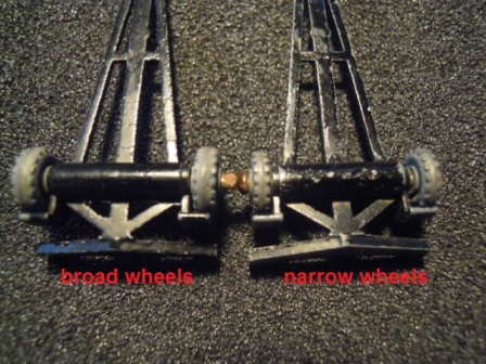

There are several types of the metal wheels, broad, narrow, with "21".
- DSCN5509.JPG (81.33 KiB) Viewed 2624 times

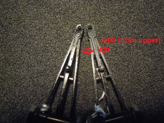

Here is the photo of the triangular infill.
- DSCN5508.JPG (128.29 KiB) Viewed 2624 times

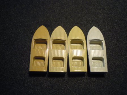

There is at least one unlisted colour variation (perhaps two). The very late boats were off white.
a) dark tan
b) light tan
c) yellow-tan
d) off white
a) dark tan
b) light tan
c) yellow-tan
d) off white
- DSCN5504.JPG (30.89 KiB) Viewed 2672 times
