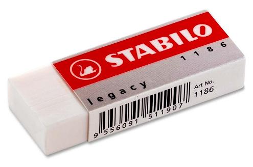

Hello Godsey1, the model looks good so very happy for you, nice catch. The gentlest way to clean the steel axles used on Lesney models is to use an office eraser, run across the axle as if you were running your finger across the axle to spin it. The axle-ends can be cleaned with the same eraser, but you will punch holes in the end surface of the eraser, it is easier with the type of rubber found at the end of school pencils.
Some patina is good on models of this type and as Mick ("SMS88"), says, it helps to show the models originality, as many fakers of such models can not resist the temptation to use freshly cleaned bright axles!
This is the type of office eraser you should buy, very handy for axle cleaning on less important models.

Thanks Ghosty. I dont think they will come that clean, i just want mine collection as clean as possible. I will check on one of thoes.
