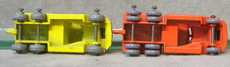

Hello elinders, as you can see on my photo the axel ends on the Yellow one have a flat head, but on the Orange one the axel ends have a dome head, the same as you show on your photo.

For the beginner, who starts to collect Regular Wheels, it is sometimes difficult to find a difference, because this difference is small. I will try to explain
The flat head axis has the shape of the small upper part of the canopy or sphere (with larger radius)
The dome head axis has the shape of the half of the sphere (with small radius)

The dome head riveted axis has small notches on its surface, which are very different in the shape and its possition

elinders wrote:Those are helpful pictures! Now I understand what to look for. I will eventually get it out and take some more pictures.
Thank you.
The photos that have already been posted are conclusive enough to judge that the model does indeed have dome head axles. This would be the main objection to considering the model as being authentic. That places a serious cloud over the model and logical conclusion is that the axles have come from a newer model. The final end conclusion is that the old axles were ruined when they were taken off to repaint an orange model into a yellow model. That's how the model presented in this thread has come to be called a fake.

Hi again, I would like to add that it became a matter for me when I saw the paint on the broken part of the tow bar. Which is impossible with the original paint.
Antonin is correct, the model has flathead axles, but the axles on this model are also too thick and too short crimped
