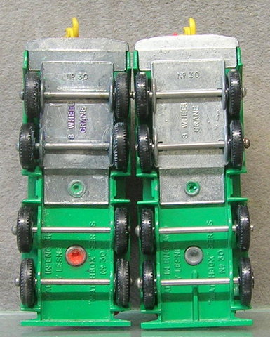

Posted: Tue Aug 07, 2018 12:56 pm
by kerbside
As you can see my one with-out the rear brace has got the wider wheels than the other one.
Re: 30c Faun 8-Wheeled Crane
Posted: Thu Aug 09, 2018 5:44 pm
by DrJeep
Interesting, and you’ve made me measure mine. This is what I found:
Braceless (2) 3.1 mm and 3.3 mm
Orange rivet (5) 2x 3.1 mm, 2x 3.2 mm, 1x 3.3 mm
Unpainted rivet (1) 3.2 mm
Tow guide (2) 2x 3.4 mm
I’d suggest that there was a mix of narrow wheels at the start of production, with much wider wheels at the end.
