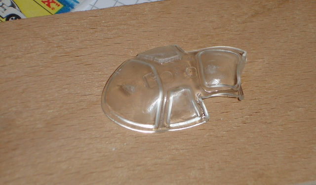

by paelzermaen
First try was with a hot nail to get the heat on a very small area of the plastic, but was not succesfull at all. Plastic just melted and sticked to the nail. OK, that was expectable.
Next try was heating up slowly in the oven, over a wooden form which follows the shape of the window insert. but between 75 and 90 degrees Celsius it just becomes soft and went banana. I think, when the softening point is reached, instead of filling the cracks inside, it just follows the internal tensions and shrink together.
The good thing is, now I HAVE to dismantle another Ford Group 6 to get a undamaged insert.
