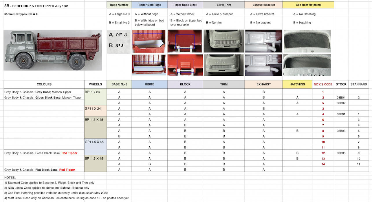

After looking through previous topics on 3B Bedford Tipper variations, and discussions on the validity of tipper bed ridges and exhaust braces, I thought I'd examine my own collection. I have 5 Tippers, all different variations as shown from my own 'Stannard' Style catalogue sheet below. (All photos on the sheet are from my stock except the ridge and block)
(My cataloguing system consists of Lesney model number / my stock number per model in the order I bought them )
Sheet updated 6th May

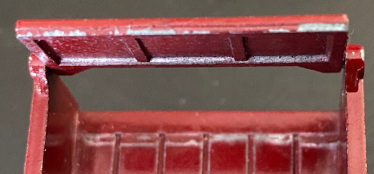

Raised Ridge on Tipper Bed : None of my 5 variants have a raised ridge, but my 03B02 has a painted ridge similar to those shown in previous 3B threads. (see photo) I can see how this can easily be mistaken for a metal ridge, but the bottom of the tailgate shows wear on its leading edge that matches the ridge on the tipper bed. I wonder if Lesney painted the tailgate separately before assembly to the tipper? probably not.
Exhaust Brace: I have one model lacking the rear brace with photos shown on my catalogue sheet. I've examined it very closely and note that the surface of the chassis where the brace would be is perfectly flat with no signs of shearing from tumbling or a dimple due to malformation, also the exhaust pipe outlet has no evidence of a partly formed casting where it would meet the brace.
I've also searched through the web and found around 20 similar examples and they all appear to be early castings: BPW 11x24 tippers mostly that are similar to mine. Nick's site also lists a gpw 11x24 tipper with no extra brace. Unless anybody out there has later / red tippers without the brace then it would be very unlikely that this is a conincidence. Therefore, even if Lesney didn't design the tipper without the extra brace initially, they must have improved their processes to prevent it happening in later years.
That said, as Tinman's examples have shown previously, there are models with malformed / damaged braces, and I believe these coexist with the missing brace variations. Overall, I'll accept it as a true variation.

I need to go through mine and check what I have, have you created that table/checklist yourself ?
All the best and be safe.
Jason

Hi Jason,
Yes, the catalogue sheet is based on my copy of Stannard as I like the uncluttered style, but updated with a little colour, some photos instead of diagrams and extra variations found on Nick's and Christian Falksteiners sites. This is the only sheet I've done so far, and I want to try this style with a few Superfast models. The JPEG version on here is a little blurry due to the low file size, Here's a link to the full-fat version. https://photos.app.goo.gl/EBfztwZYhxxTLbHX9

Hi John,
Thats a great layout, I am terrible with notes. Paper everywhere, gets lost and I never have stuff together at the moment. Although I am trying to rectify that I feel its not working very well.
