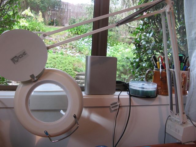

Here's a really good tool for modelling - it has a fluorescent light and can be manoeuvred around.

Rodger that piece of equipment is exactly what I need !
Certainly looks like it would come in handy.

I don't own anything like that, everything I do is by the naked Eye. I don't have a work bench or area where I can sit down and have everything to hand. When the Black Rio Phantom II was made I don't remember what I used to work on, but probably my knees like I have done with most of my creations. I will find a top of a desk or table to work on, but all the work then has to be put away until the next time I do something, very inconvenient, but something I have got used to.
