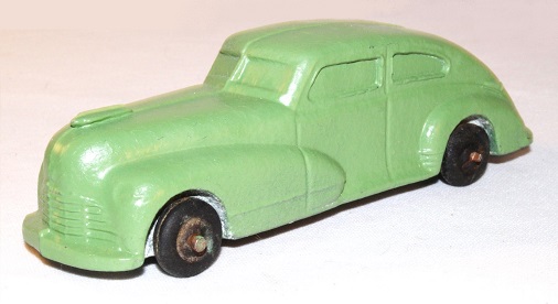

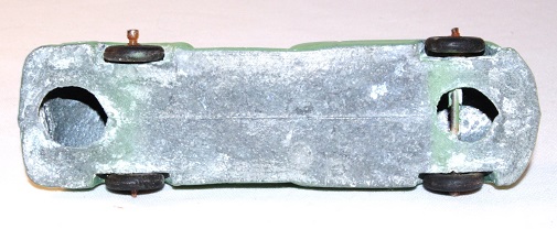

Re: Hollowcast Lead Question
Posted: Fri Jan 15, 2016 2:54 am
The 'BARCLAY' model is classed as Slush cast in America, in the UK This is often classed as Hollow cast.
The 'CRESCENT' POLICE car is die cast (the Two words should be separate, the model has been cast in a Die).
The 'KEMLOW' is also a die cast model.
The Barclay has been cast in a crude Two piece die hence the ugly moulding line (flashing of escaping metal), along the centre of the model.
The Crescent and Kemlow castings have ejector pin operation within the dies.
A true Slush cast casting has been made under gravity with sometimes centrifugal assistance to help the metal flow into all areas. Many Slush cast models have a very uneven inside surface and no open window areas. Depending on the subject, these are heavy models due to the overall thickness of the metal used.
Typical Slush cast toy car.jpg (44.29 KiB) Viewed 761 times
No window openings.
Underside of model.jpg (51.13 KiB) Viewed 761 times
Very similar to the Barclay model.
