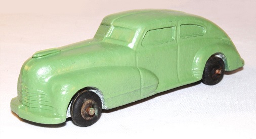

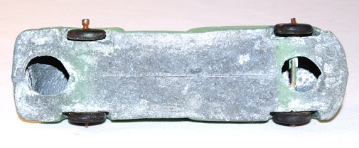

A true Slush cast casting has been made under gravity with sometimes centrifugal assistance to help the metal flow into all areas. Many Slush cast models have a very uneven inside surface and no open window areas. Depending on the subject, these are heavy models due to the overall thickness of the metal used.
Typical Slush cast toy car.jpg (44.29 KiB) Viewed 753 times
No window openings.
Underside of model.jpg (51.13 KiB) Viewed 753 times
Very similar to the Barclay model.
