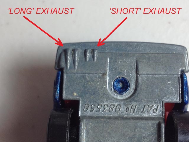

Hello Kevin C, using your own picture, I have superimposed the 'Short' exhaust next to the normal 'Long' exhaust to show the difference in length between a full production model and the 'Pre-Pro' model.

Thanks for the picture, I am so darn blind I didn't even see the exhaust pipes at all! :)

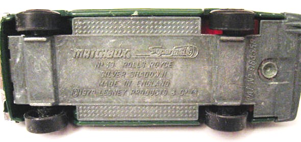

Here is a model from the same period as #39 Rolls-Royce and this is a 'Colour Trial' model, fully finished and produced on the same 'Flow-Line' as the full production models, it's rivet is very distinctively formed with no or very little paint in the 'Countersunk' area.

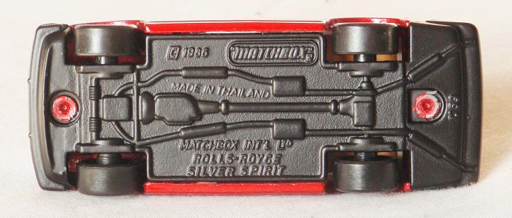

Here is a model from the late-80's with another typical rivet, from Thailand.
