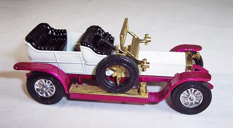

In 1974, a further Ten 'Yesteryear' models came to market, including the Y-10 in it's new colour of White over Red-Purple. It had the 12 spoke wheel and tyre combination instead of the 24 spoke design, which when it was fitted to this model looked much better in my opinion.
- LATE 1974.jpg (50.56 KiB) Viewed 890 times
This is now the new colour for this model until another colour change in 1979.
During the production of this version, there were more casting modifications to contend with than before, including some exciting seat colours...!
