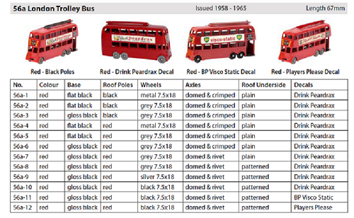

This is getting a bit complex, so here's Houghton's original listing for comparison with the models detailed above:
You can see very clearly how he links the plain roof to early production and the cross-hatched roof to later production.
What do members think? Is it likely that this model had twin moulds throughout its production life?

nickjones wrote:3 with gloss bases all with bpw - 1 xh roof 2 smooth
2 spw with gloss bases 1 xh roof 1 smooth
4 gpw 1 with matt and 3 with gloss - 1 xh roof 3 smooth
3 gpw with matt bases - 2 xh roof 1 smooth
BPW/cross-hatched roof is not listed by Houghton
SPW/smooth roof is not listed by Houghton
GPW/matt base/cross-hatch roof is not listed by Houghton
kerbside wrote:1 Black poles MW Gloss Base Smooth Roof.
1 MW Flat Black Base Smooth Roof.
1 GPW Gloss Base Smooth Roof.
1 SPW Gloss Base Smooth Roof.
1 BPW Gloss Base Cross Roof.
Only the SPW/cross-hatched roof doesn't tally with Houghton
Martin Avis wrote:I have four examples as follows:
MW d/c, smooth roof, matt base
MW d/c, smooth roof, silk base (halfway between matt & gloss)
GPW, d/c, smooth roof, matt base
BPW, d/r, xh roof, gloss base
Those fit Hougton's list.
Perhaps we should look at this from another angle: does anyone have a black-poled, cross-hatched roof example? (Mine is smooth.) If the answer is no, that would indicate that the cross-hatching was indeed a casting modification later in the model's life.
Re: 56a London Trolleybus
Posted: Sat Nov 08, 2014 9:08 pm
by nearlymint
Just checked 4 black pole models all smooth, I have GPW and BPW models with both smooth and cross hatch, SPW model has cross hatch.j
Posted: Sat Nov 15, 2014 8:05 pm
Well, that's five black-poled examples with smooth roof and zero with cross-hatching. It looks to me as though Houghton might be on to something.
