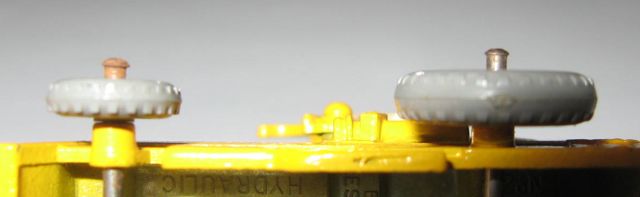

Hi Roger, thanks for all the hard work you have put-in on taking all those extra photos and the very accurately described comments. If I had only seen the pictures of those axle-ends, It would ring alarm bells suggesting you have many 'Tampered-with' models. However, you seem to be a Guy who knows his stuff and I am sure the models you have shown are genuine, as far as you know, plus the chances of every model in your collection being a 'tampered' example is pretty remote.
So where does this leave us...
You seem to have provided evidence that Lesney sourced axle-ends from this period of production for the Karrier Bantam, can be very in-consistant and the fact that so many of them have aged and rusted confirms this, it is very difficult to age and rust clean steel to the same level as shown on your examples.
Where this puts your yellow Karrier Bantam I am not sure, I think we can agree on the overall damage, but I think we still have to have reservations about the axle-ends, despite what you have said and shown, maybe some more research and more models to be found to help give your model the credit its due.
On another thread, I stated something about not destroying known faked or tampered models, because we can use them in such articles as this one here and a lot can be learned from such models, in many cases the method of how some fakes have been created can be discovered by having the models.

This rare wheeled Coke Truck axle problem is one every veteran collector has come up against at least several times. If these axle ends were on a 'common' variation, I still would have to question the front axle dome. As you pointed out and I stated, the rear axle has the flat center of Lesney production axles as we know them. It is the front axle that looks non-factory without that center flat area. Perhaps by providing such clear and distinct pictures of your axle ends and some of those in your collection, we are all left wondering HOW consistent Lesney workers had to be in order to secure these riveted axles. Hitting them lightly with the spinning tool would leave the end of the axle flat only if that axle were cut flat to begin with. If that axle were cut at any kind of angle before spinning occurred, there certainly is a chance a defective or 'fake looking' axle end would result. You have now pictured some strange and 'fake looking' examples from your collection tractorboy. Note that it is fairly common to find some Lesneys with their axles installed in opposite directions, giving you one domed and the other spun on each side of the model.
Do we expect ALL 'rare' Lesney wheel combinations to have both perfect factory Lesney axle ends on them? YES! If they are not both perfect, doubt will still be in your mind about this rare piece 40 years from now tractorboy. Is this fair thinking? No, but my views have never changed on pursuing 'correct' Lesney axle ends on my rarest Lesney examples. I rather have a poor example with perfect axle ends than a Mint example I am not sure of. I see the point of your other bad riveting examples presented, but these examples do not give me any more confidence on rare models with even one defective looking crimp OR rivet on them.
Numi made the most valid point of axle ends being larger just under the rivets from peening them into the domed shape we know so well. Lesney always 'spun' the ends into a domed rivet with a proper shaped tool. With that method, axles remain consistent in diameter up to the rivet just like all but one of your supplemental pictured models illustrate. I would now have to question that sole model's originality also if it were mine with the ballooning of the axle under it's rivet head as shown.
None of this is meant to be critical, all are just points for everyone to consider when viewing and buying any of the rarest Lesney regular wheel variations. kwakers

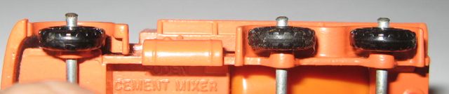

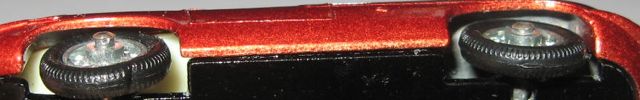

Thanks ghosty & kwackers for the comments.
Yes, certainly agree with the comments about perfect axle ends and the easiest reason to the Karriers axle ends is what I first believed, hand peened ends.
Is it just my collection that has other examples? If yes, then I would have to assume that they too are fakes (now thinking should I get more out to have a look at).
The difficulty I have understanding is how there is a mixture of well formed, correct ends and what appear to be hand peened ends as seen on 3B Bedford IMG_5832, 10C IMG_5810, 11B IMG 5822.
I also pulled out another drawer and examined 40 models and found 5 with ends that would be classed as non standard or not 'correct' Lesney ends.
The Weatherill has one axle with corrosion and the other fairly clean.
Is this unusual, am I just unlucky to have this number of suspect axle ends?
Does anyone have examples of similar to this is it just me?
