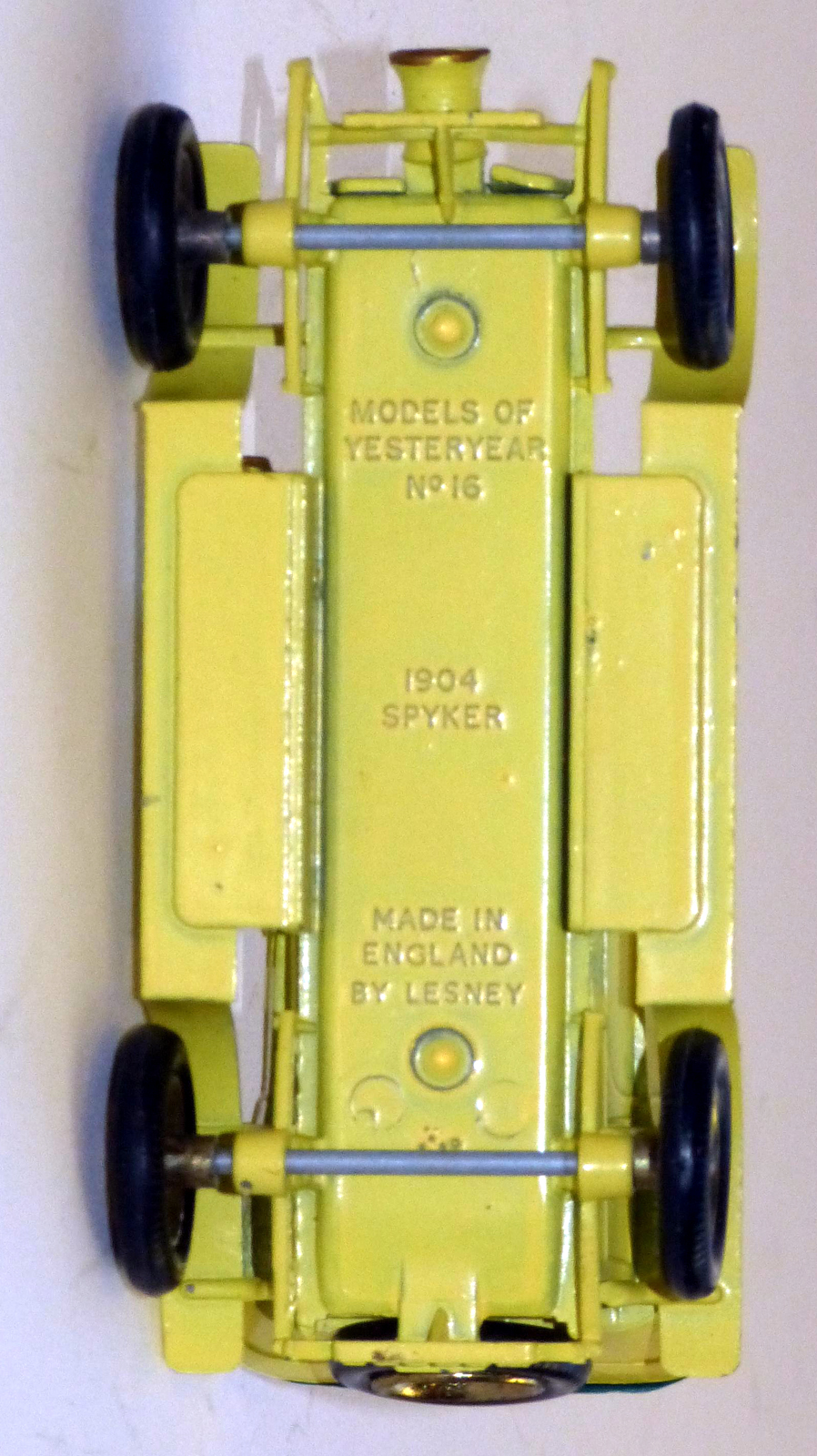

I have a Matchbox Y-16-1 1904 Spyker that I'm pretty sure has been factory-overpainted. Green can be clearly seen underneath the factory yellow and, in my meagre research, I found out that the 1960 or 1961 Matchbox catalog shows a two-tone green one which, so I understand, was never released. For those naysayers who might think someone did this on purpose after the fact, I can tell you I'm the original owner and only noticed it a couple days ago. So, I'm looking for more info from those more knowledgeable than me. I tried uploading several pics showing all sides and the bottom, but this is the only one that loaded. Might need some advice on how to do that.

A picture of the baseplate is essential in determining a models status so when you can, please try and upload those other pictures.
Overpainted models within the yesteryear range are known and come about when old stock painted castings are put back onto the flow line to be built up as finished models in the next season's new colour scheme.

The base is the most relevant to this showing the legend on the base clearly 'Models of Yesteryear 1904'
Re: Factory Overpaint - Y-16-1 1904 Spyker
This model has the 2nd type of windscreen and steering wheel, and later wheels. It's very unlikely to be a preproduction casting. Baseplate detail as Mick says will prove the point. Green and maroon models were prepros, and have specific fonts in the baseplate lettering that determine this status.
Base picture now added in the first post.

TradeFreak, what makes you think that the baseplate might be overpainted? Are there any areas with green showing through? (the problem is that the baseplate on your model is a later version than those which are known to have left the factory in green.)
