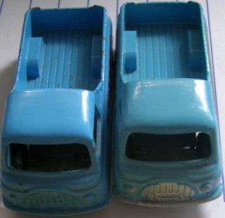

The colour difference actually shows up very well on my monitor. I wonder if, in typical Lesney fashion, my c/a model could be a later (i.e. lighter blue) body paired with an earlier baseplate?kerbside wrote:I have checked the Blue colours there is a slight difference, more in the hand rather than in the photo.
