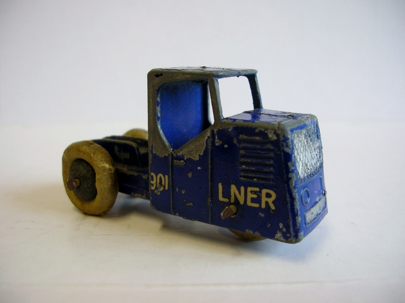

The joblot which yielded my Large Scale Dozer contained another 7 items, all Dinkys and 6 of which I had already decided to sell on. This LNER Mechanical Horse was the only one that fell into 'what am I going to do with it' territory. So I did what I always do, consulted Nick's site :D

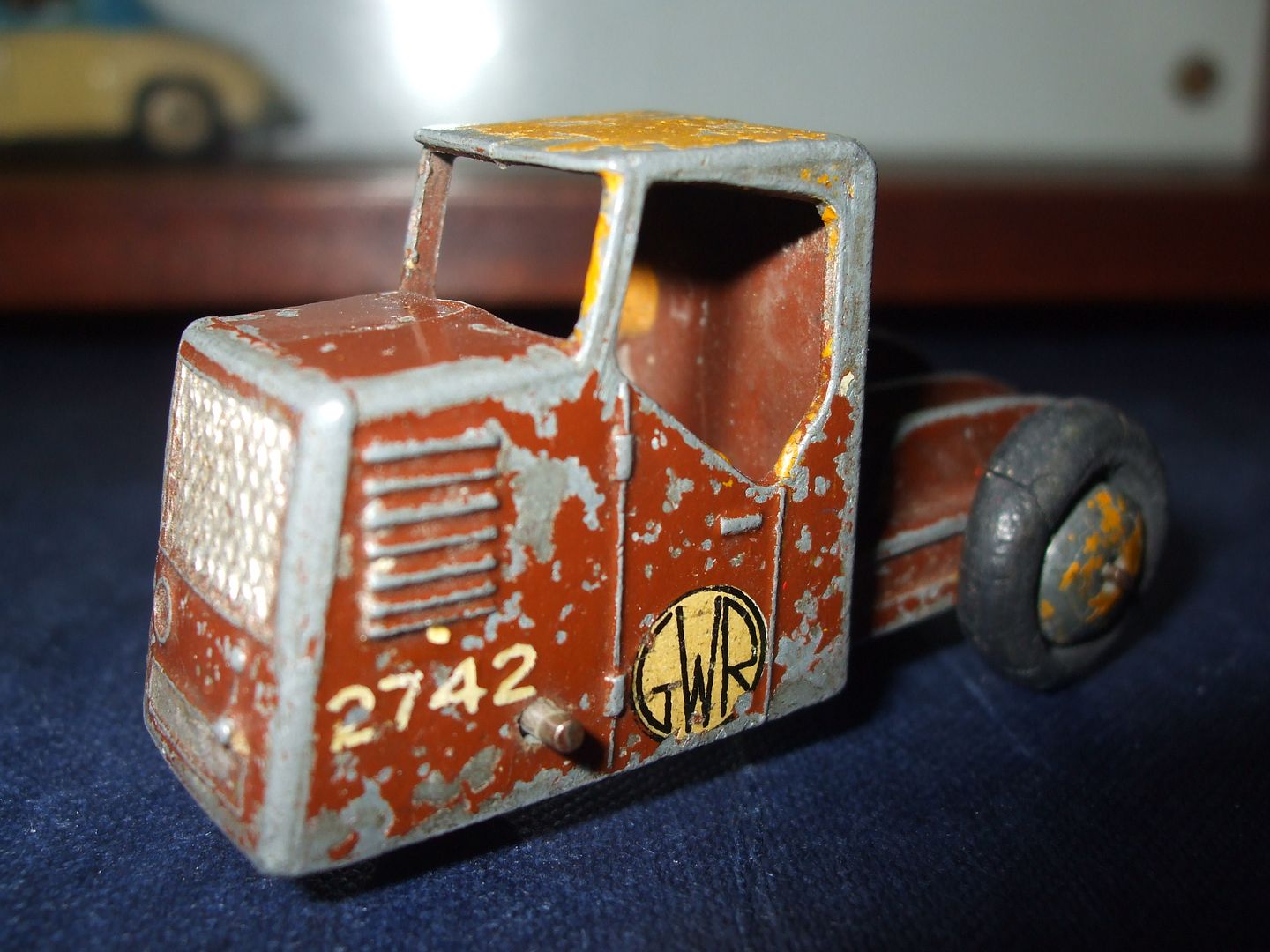

It seems that this, and a huge variety of other Mechanical Horses was produced from 1935 to 1940 (the Castrol tanker is seriously nice), including one for all the 'Big Four' railway companies of the time. Some of them were reintroduced in 1946, but not the railway ones, I suppose the approaching creation of British Railways stopped that. From 1947 onwards all that was made was the rather dull version with open trailer. A quick gander around ebay saw 2 railway ones - a very smart LMS version on 'Buy It Now' for £250, and what appears to be the bottom half of a GWR tractor unit. I think this one is a 'keeper' now, joining a Major Bedford S and 2 Major TK units waiting for a cheap trailer one day.

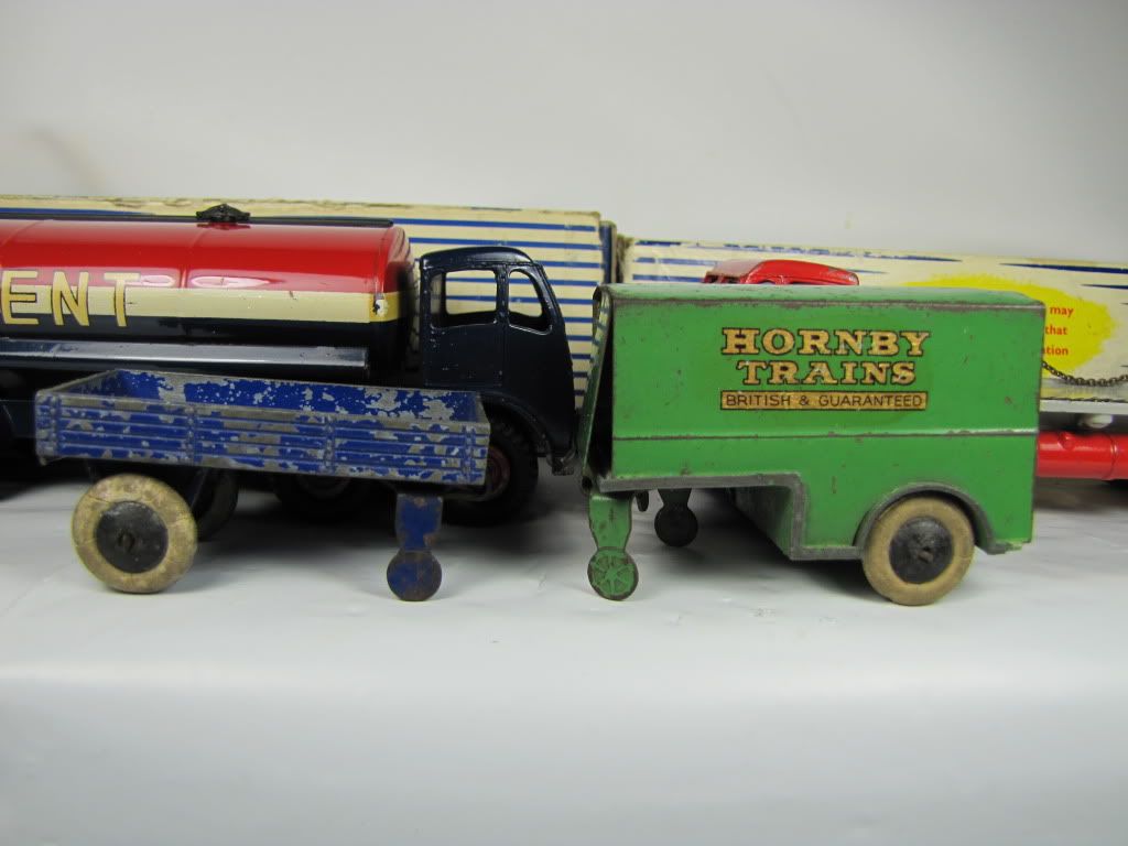

I only have these..........
So I'm still missing a GWR Trailer, and the full LMS unit, also the box van with Hornby Trains logo, and lots of other Tankers / Dustbin Waggons etc etc,
Chris Warr.

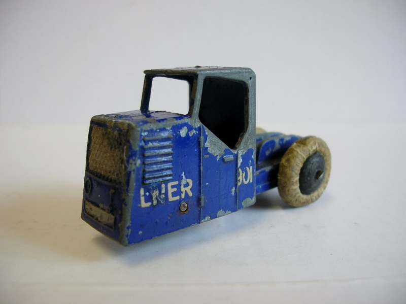

I don't know if you can make it out on my pictures, but there is a patch at the nearside top of the radiator on mine that I thought may be fatigue? It reminds me of the corrosion I used to see on cast aluminium outboard motors except it doesn't look powdery. Is there anything that can be done to stabilise it or is it a process that just keeps going once it's started? I have enough experience of various types of corrosion on 1:1 models to have learnt not to poke around these things :D

Hi Ewan, Your model does have a mild case of metal fatigue, it is a result of the zinc crystallizing so there's nothing much you can do to repair the damage.
I'm assuming you keep them indoors which should stop it getting any worse due to keeping it at a stable temperature and humidity. also keeping it out of contact with other toys will help,
