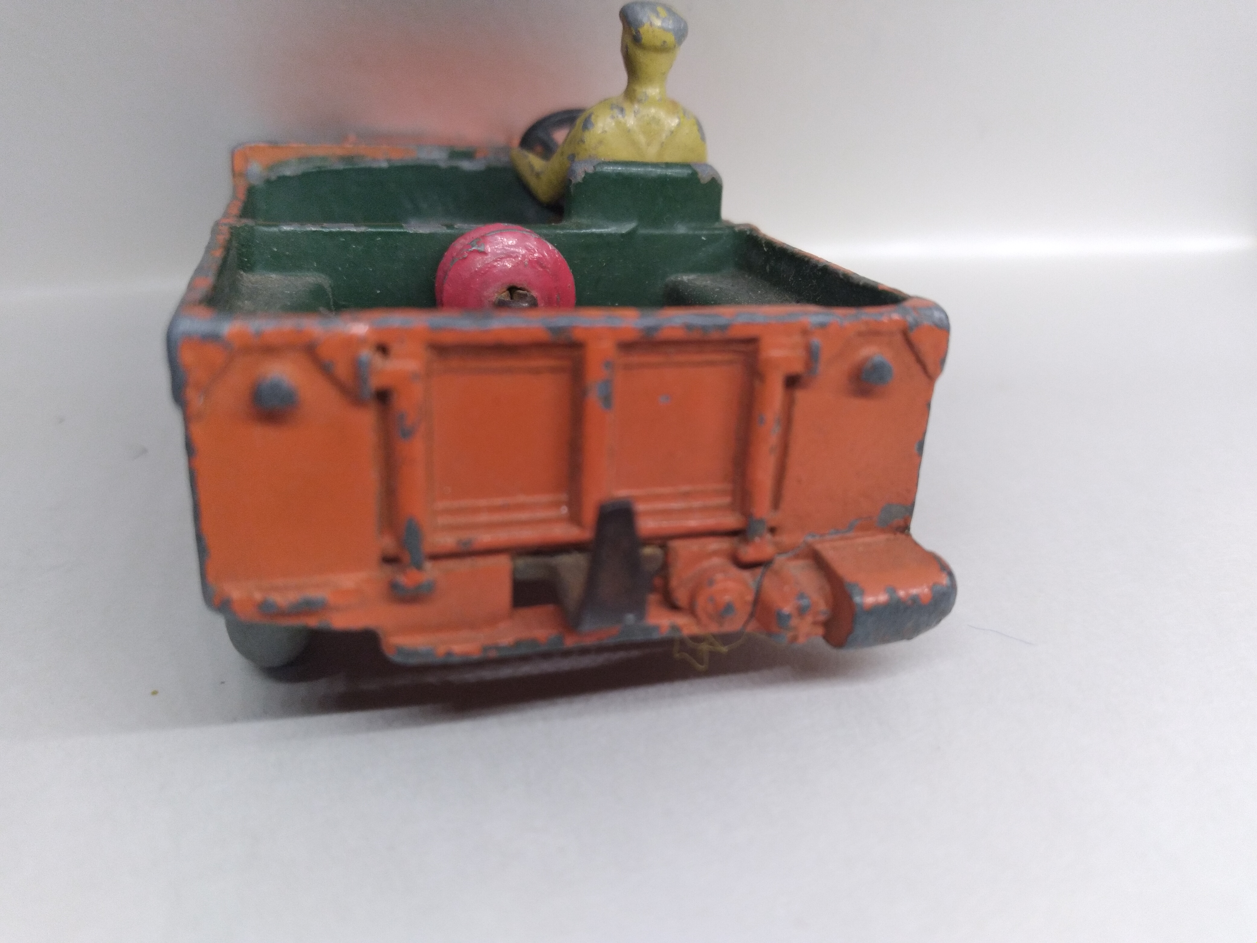

Today I received my first Dinky. One of its axles is bent, and there is an area of far greater concern: the body has a crack around the rear PTO unit. (In the attached photo, the crack is visible underneath the right tailgate hinge.) Can this crack be fixed, or is this model suitable only as a parts donor?

You have a couple of choices. JB Weld or baking soda and super glue. Either way, there will be a need for fine files to shape the repair to match the original shape.
Edited to add a link to a repair of the same Dinky ... https://www.youtube.com/watch?app=desktop&v=Ivm3KRK2_uc

Thanks for sharing the video...it will be most helpful when it comes time to restore mine. I'll have to keep an eye on the crack and make sure it doesn't spread. I'm glad it's not consigned to the fate of parts donor!

Not knowing anything about the age of this particular model, my worry would be Is it metal fatigue or just damage from abuse?
Re: Dealing with cracks in Zamac
I think this is far too late in the Dinky timeline for fatigue to be an issue.

I would (and do) take a different approach. This advice is for for hairline or fine cracks, not metal fatigue or if a part has separated and must be glued back in place. Fill the crack with a low viscosity air dry glue. Any excess can be wiped away and once dry the crack is filled. If shrinkage causes the crack to still be noticeable, make a second application. When dry, put the model in primer and make an assessment of the crack's appearance. With this method, no sanding needed, no details are obscured and it's fast by comparison.DGinBC wrote:You have a couple of choices. JB Weld or baking soda and super glue. Either way, there will be a need for fine files to shape the repair to match the original shape.

Are you leaving it in distressed state or totally restoring and repainting?
I'd go with the low viscosity industrial superglue method without accellerator and be careful with the paint stripper,
You don't want paint stripper seeping into the crack.
