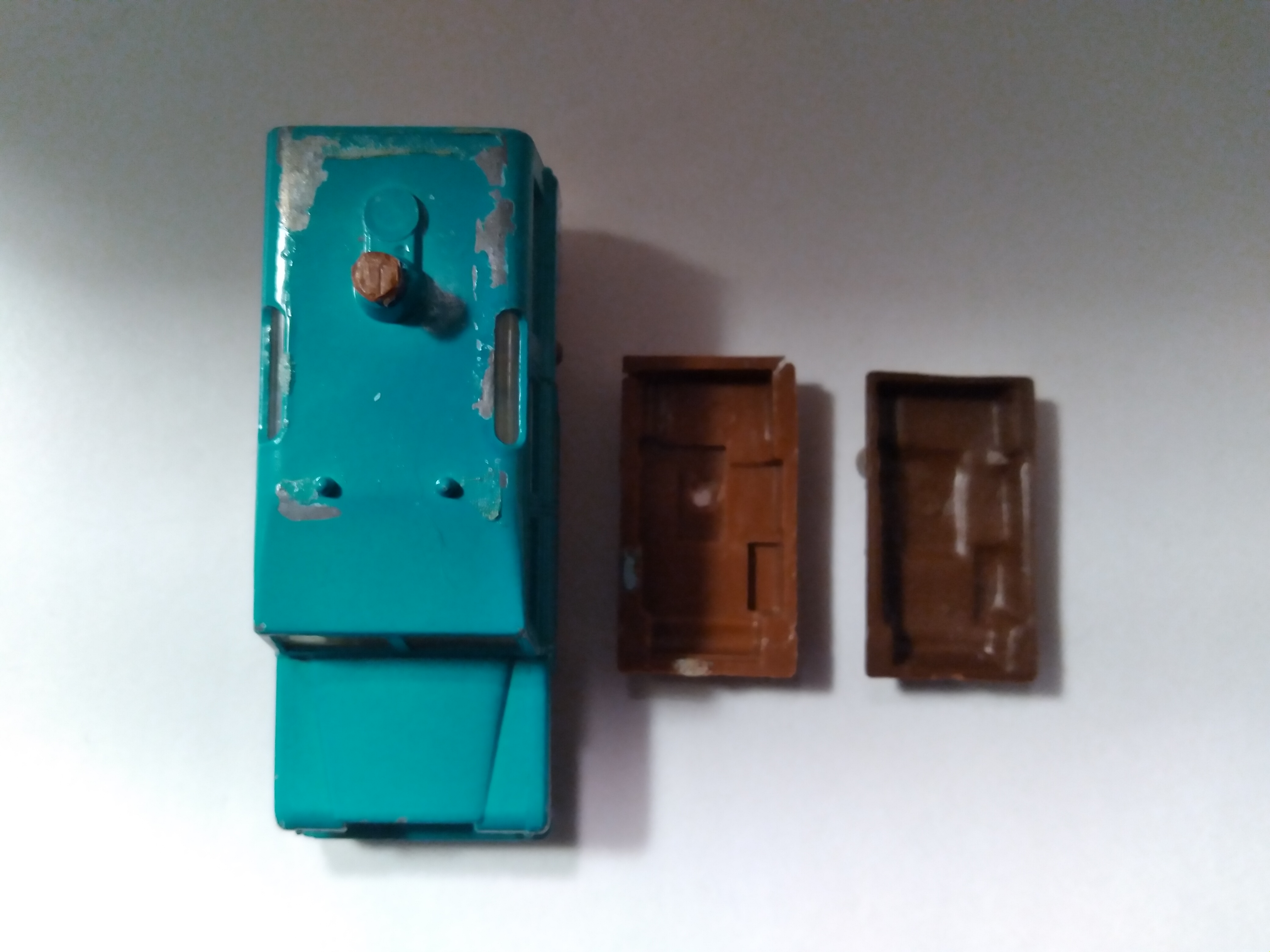

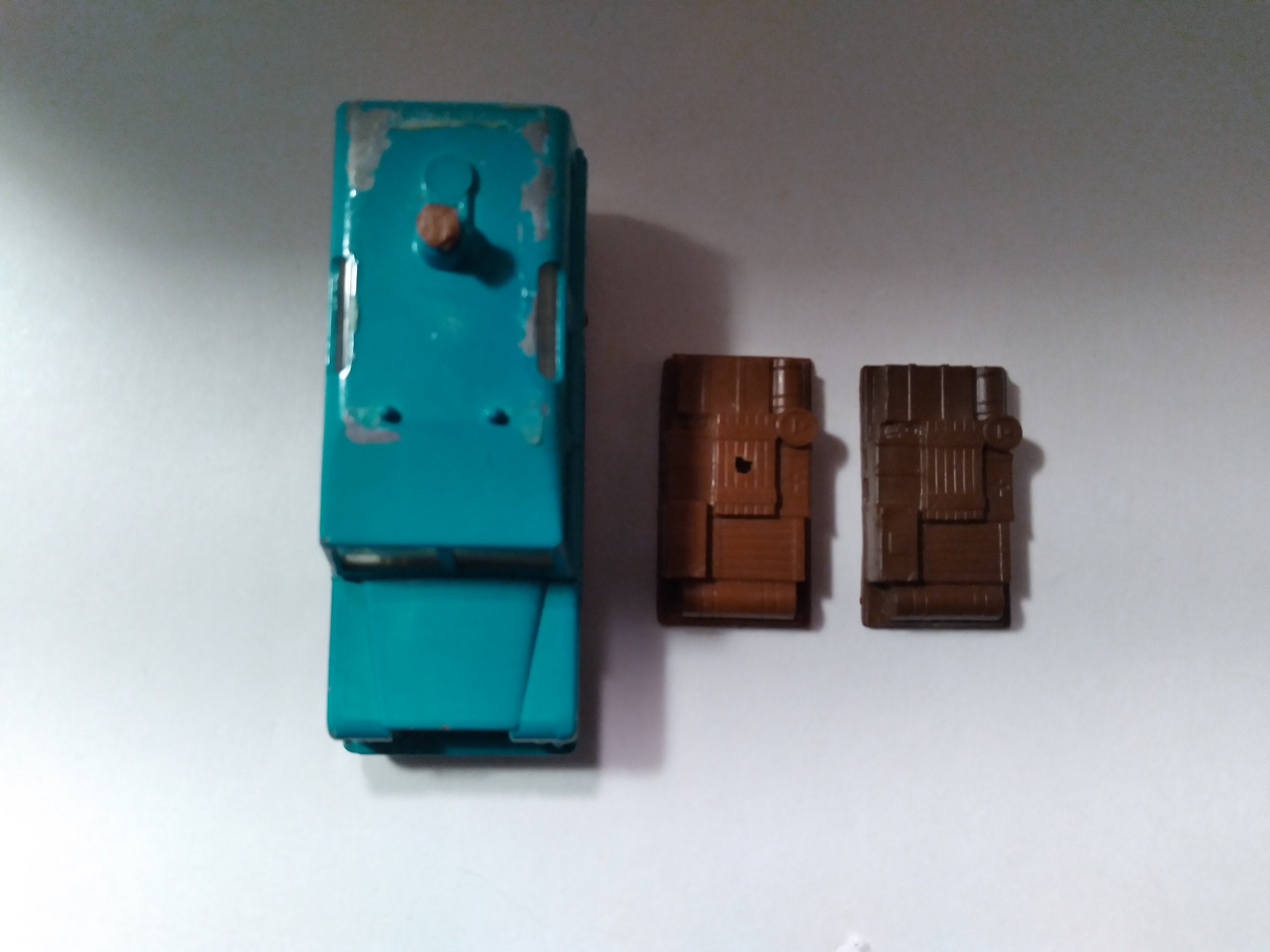

The luggage I received from Mr. Flowers has no nipple molded in. It must have been redesigned, and it's also slightly smaller than the original. Some pictures are attached (original part on left, reproduction part on right), which also show the sad state the model is in.

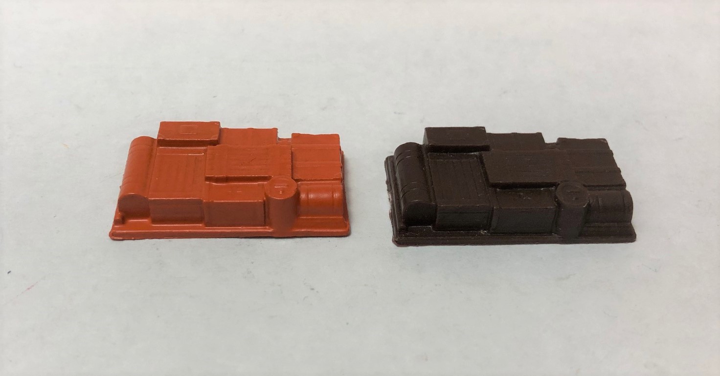

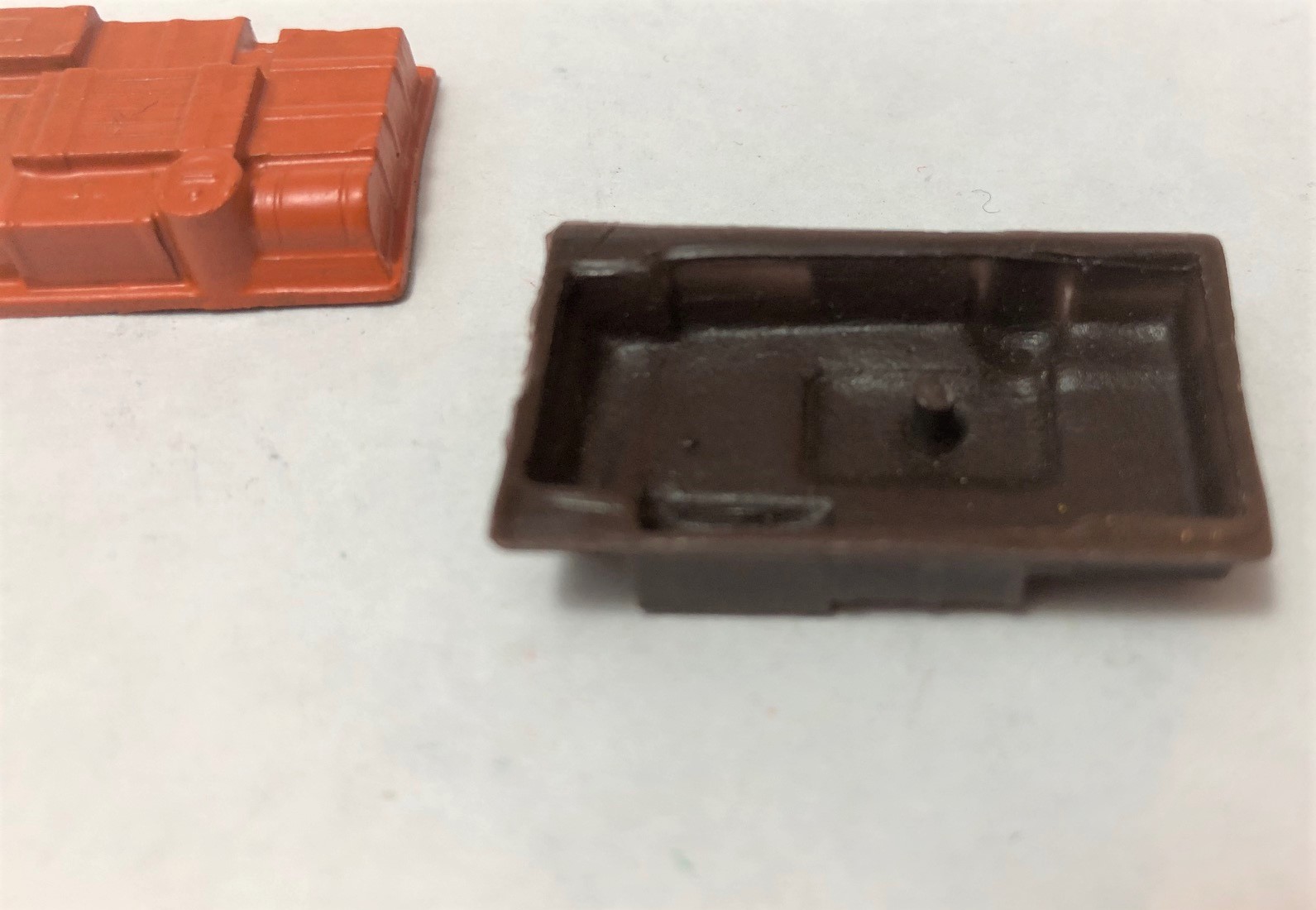

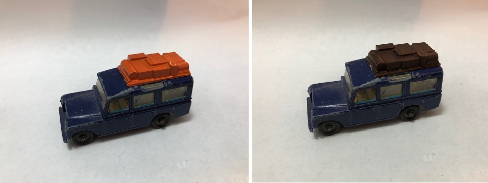

Here are pics of two Flowers luggage castings and as you can see, they both have the nipple or pip that fits the model.  So, as you say, Steve must have changed his casting at some point in time.  I have painted one a burnt orange so it matches the early color luggage and if I use the darker one, I will paint it a lighter brown to match the original.
Your new luggage can still be glued into place and you can still use the school glue. Place it around the lower edge and clean up any excess using a cotton bud dipped in warm water (squeeze off the excess water after dipping).  Or you can use a two part epoxy putty by placing a ball of putty over the existing hollow stud. Make the ball big enough to contact the underside of the luggage and surround the stud on the roof (get the broken off old nipple out of the stud first).
