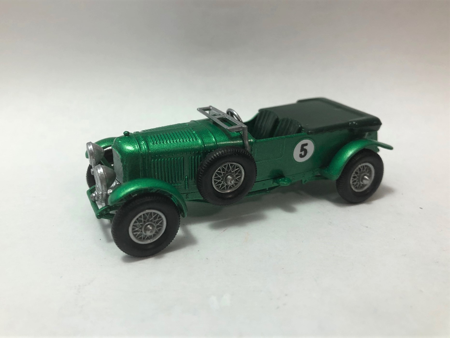

This Y5 Bentley was more work than it looked. All the white metal parts were bent and there was some white knuckle moments heating and straightening them. The steering wheel, the headlights and the windscreen all needed to be carefully straightened. One front fender had to be heated and straightened too. The original headlight assembly was too far gone (bent up and missing one bucket), so I had to use another bent up set off a newer model. That required some modifications to make it work on the first issue casting. All I'm waiting on now is for the Union Jack decals to arrive. Since I was lucky enough to find a half way decent first issue casting, I painted it in the first issue color of Metallic Green.

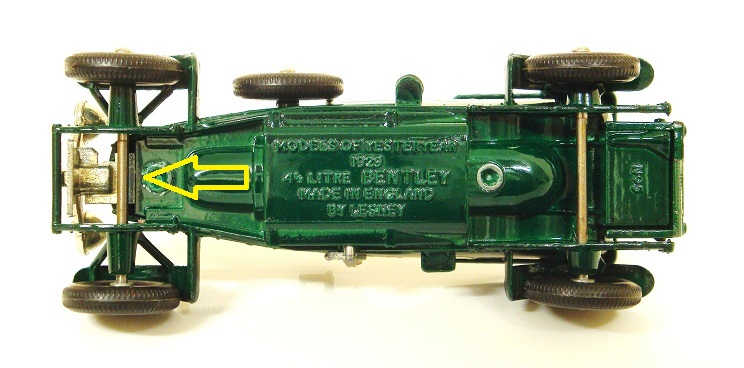

OK, the following images will be found on 1st casting Y-5(B) Bentley models.
1, The baseplate will stop short of the front axle.

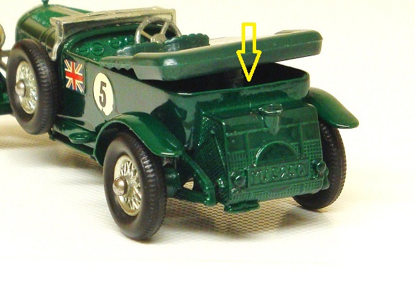

2, The top edge of the rear panel under the tonneau cover does NOT have a cut-out.

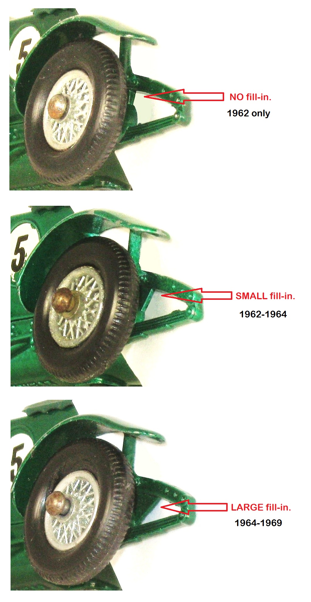

3, There is a small fill-in between the rear springs as shown in the middle picture of the three below.
Ignore the top picture of the three as this is for the preproduction castings.
