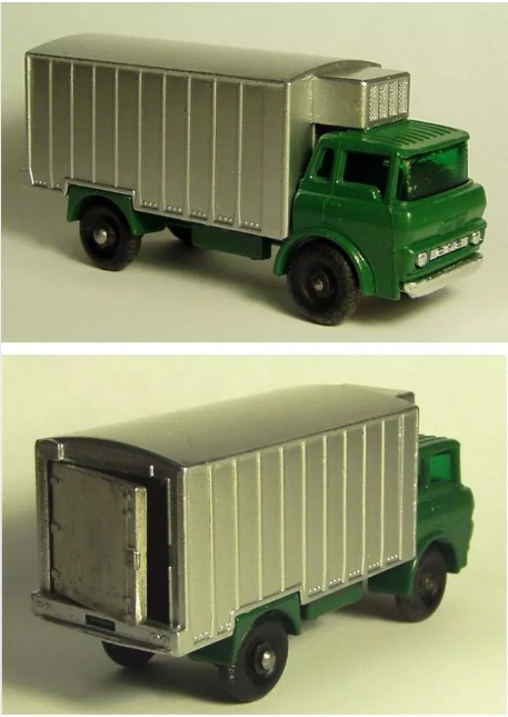

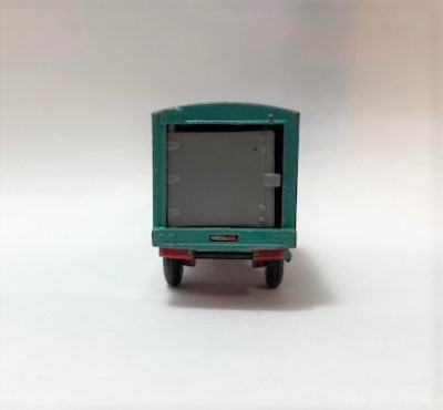

I got a couple of the reproduction rear doors from Steve Flowers, for the Matchbox 44c fridge truck. They are now made of plastic, like the originals were. Previously, the reproductions were cast in white metal. The white metal replacement doors were cheap, the new plastic ones are more expensive (why?). The new plastic door looks great, until you install it on the model. The first pic shows the plastic door installed. It contributes to global warming as the refrigeration unit on the truck must run overtime to keep everything cold and the stuff at the rear of the truck would surely be spoiled very quickly. This part is a complete fail and a new mold needs to be made - unacceptable! It gets a "Do not buy" rating from the TinMan.
In the second pic you can see the old cast white metal door. It looks great and fit great. The inside edges were even tapered inward for an excellent fit.
Mr. Flowers, please discontinue the non-fitting plastic door and go back to the excellent fitting cast metal door (or replace the mold for the plastic door with a new mold that creates a door that fits)!

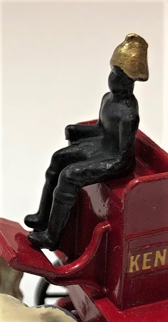

Shand Mason replacement driver FAIL. Instead of a new Fireman I received Captain Hook (minus the hook). I guess hand failed to form. I can understand that spotting the missing end of the drivers arm might be a little difficult when your working with a bunch of different parts and castings all day. But then again, it's the same bunch of castings all day and every day. Would a little quality control be too much to ask when you are filling an order?

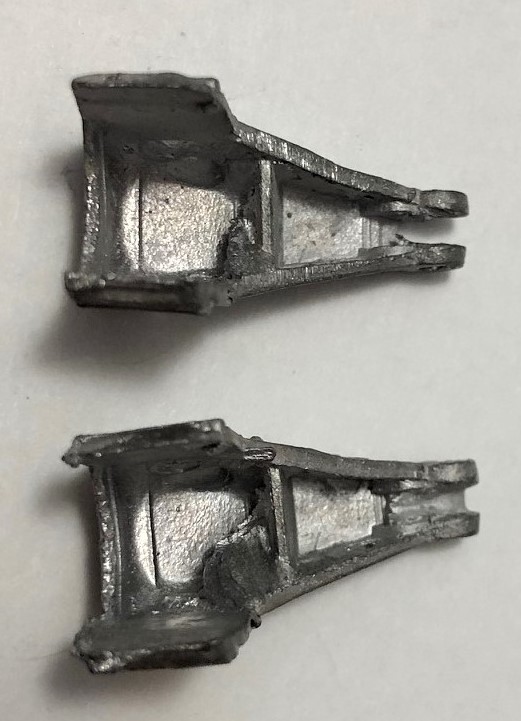

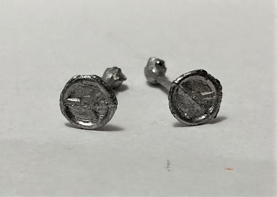

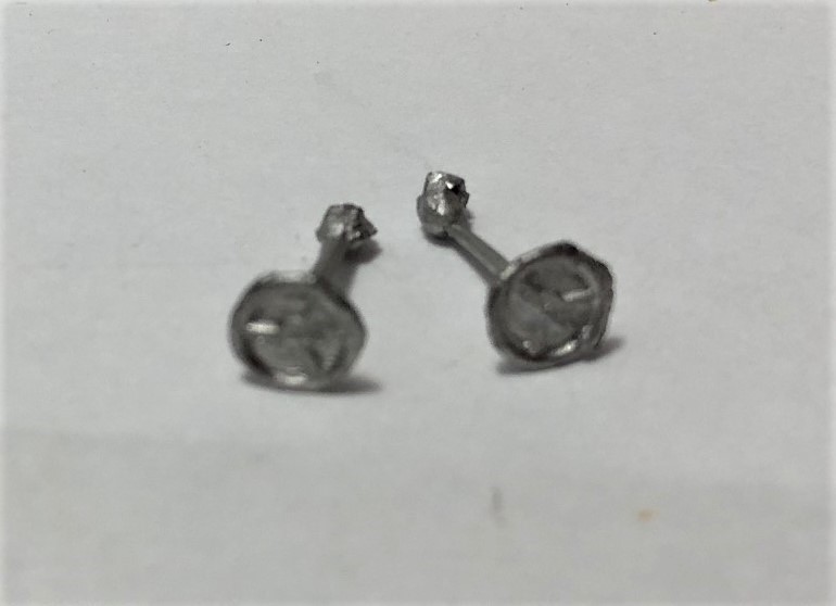

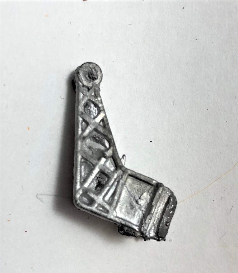

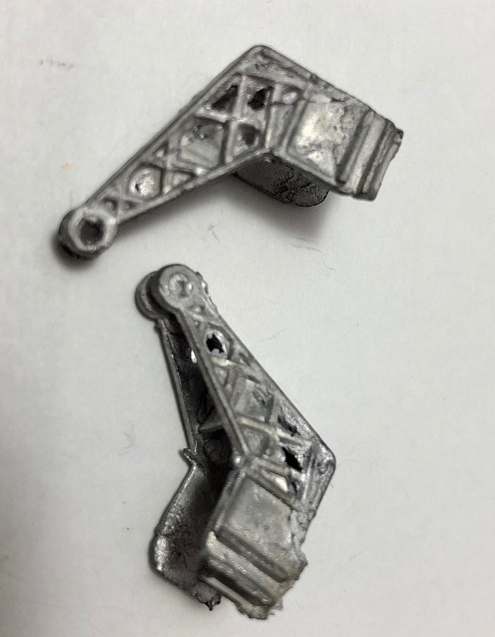

OK, so I used the driver cause I've been waiting forever to get one. But these steering wheels are just going in the trash can. The small end is supposed to be a sphere, a ball and the actual steering wheel part - Oh Please! Then there are these useless booms for the 13a. If it were not for the cross member underneath (with the huge blob of flash) I might be able to open up some of the webbing with a needle file. As it is these are just junk too. Obviously, my hopes for any quality control ... well all hope is lost with this stuff.

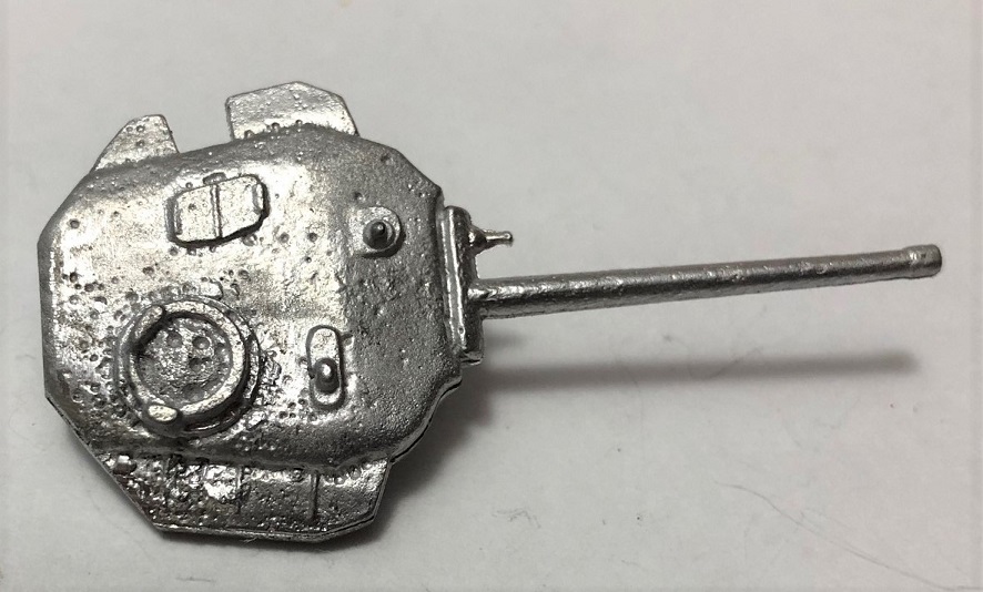

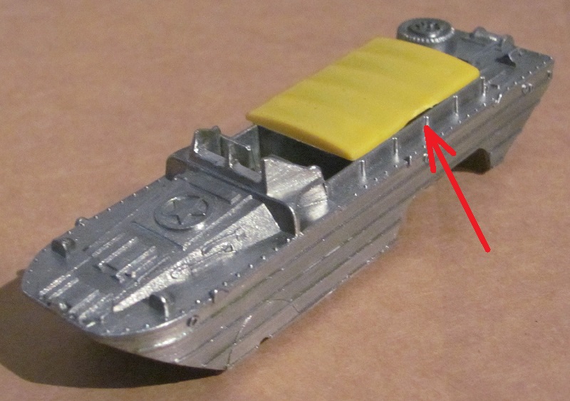

There are more far less than ideal replacement parts, maybe discussing more of them is boring. On the other hand, maybe it would be nice to have a list of which parts are not worth the effort to purchase. I know some of these white metal castings are not that expensive, yet when you order several of them it bumps the weight and shipping overseas is expensive. Not to mention the wait time from placing an order to the time you receive it, only to find a bunch of stuff that's unusable. If there is enough interest, we could compile a list of parts (including decals) that are not worth the effort and save us all some time and money.
I also want to mention that there are a ton of really great parts (metal & plastic) that are made to help us restore and repair our beloved vintage models and I'm super grateful they are available. My comments are not meant to pick on any one dealer or manufacturer of these parts.

I have to say that most of the plastic repro parts that I have bought from Steve have been very poor.
The canopies for the MB1 Mercedes and Trailer are a very loose fit and a wishy washy orange.
The canopy for the MB61 Alvis Stalwart (see photo) is also too small and arrives with the sprue attachment point hacked away and therefore needs a bit of filler which is a shame as the colour is good but because of needing filler will then require painting.

The problem with these plastic parts is that they must be reverse engineered. The moulds being made from original parts are always going to shrink smaller.
If the plastic item fits into a single hole then it will most likely be okay but if there are two or more attachment lugs, then they most likely won't fit.

Re- the Stalwart canopy, I would prefer it attached to the sprue so that I can trim it myself. I can live with it being a tad small as it only has to sit there.

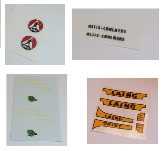

Some notable decal "FAILS"
The 6b decals for the Euclid quarry truck should have the man point one way on one decal and the other way on the second decal. That way they both point forward when installed on the doors. FAIL.
The 47a Tea Leaves are like the men pointing on the Euclid, in other words the stems of the teas leaves should both face front (not one facing front & one facing rear as these do). FAIL.
The Allis Chalmers "260" should always be at the top. The decal is correct on the left side but upside down on the right side. FAIL.
The Scammell K8's door decals never came in this color and were always black lettering on a white background. FAIL.
The big three sell these decals (stickers in the case of Rick's Toy Box). However, Black Square does get them correct. Black Square also does a better job on getting the size or scale of some decals more accurate than the others.
