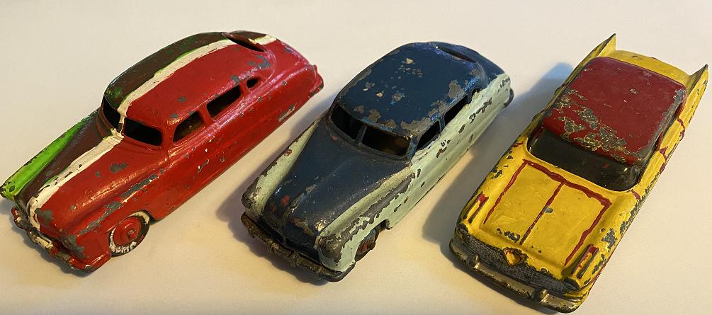

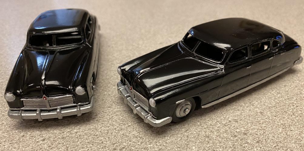

A friend gave me a trio of rather troubled Dinky Toys Hudson models. I started with the two on the left. They depict the 1948-49 Hudson Commodore, the first Hudson of the so-called "step-down" era.
dinky models (2).jpg (85.46 KiB) Viewed 2541 times

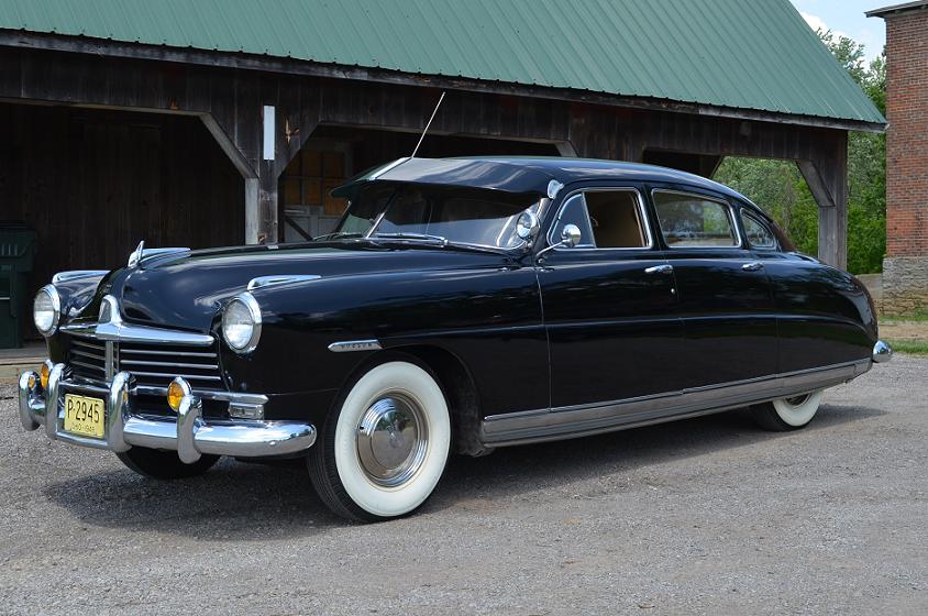

My intention with both models was to create a replica of our 1948 Commodore.
hudson images mothers day 2017 006.JPG (132.35 KiB) Viewed 2541 times

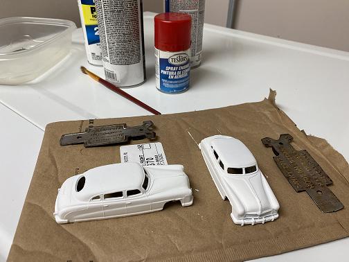

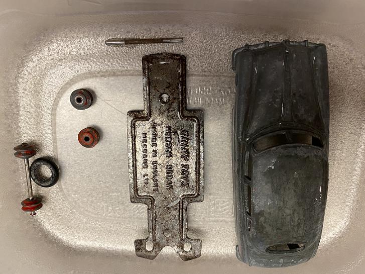

Stripped...
Primed...
dinky models.jpg (43.42 KiB) Viewed 2541 times

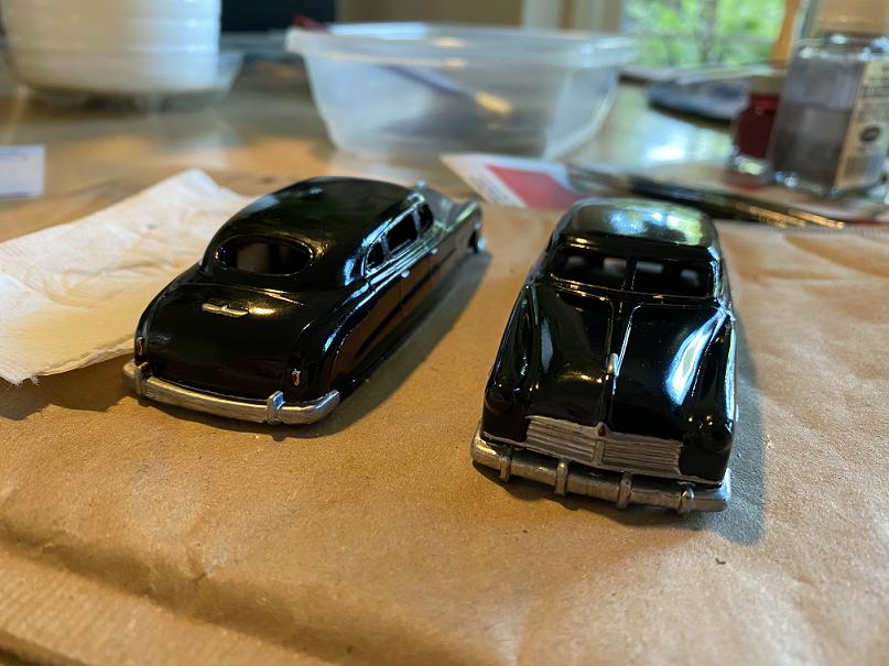

Detailing...
dinky models (5).jpg (80.54 KiB) Viewed 2541 times

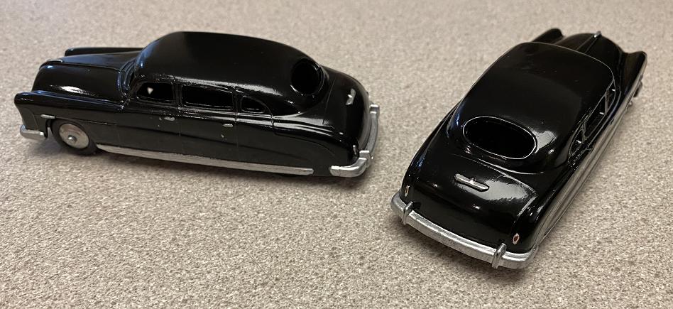

Final products...
dinky models (4).jpg (105.55 KiB) Viewed 2541 times
dinky models (3).jpg (101.25 KiB) Viewed 2541 times

It just occurred to me that I posted a photo of the models with primer. Sadly, when I painted over the primer I got a nasty crackled paint reaction in patches. It looked as if black snowflakes were erupting through the paint.
I stripped the paint and primer and repainted without primer.
The Tinman is so learned about this stuff. He asked me what primer I used. I told him I used the primer he told me to purchase for the earlier plaster model that I restored.
He explained that while that primer is good for a porous surface like the plaster model, it was NOT a good primer for a metal casting.
I'm grateful to have the ultimate authority as a resource on such matters.

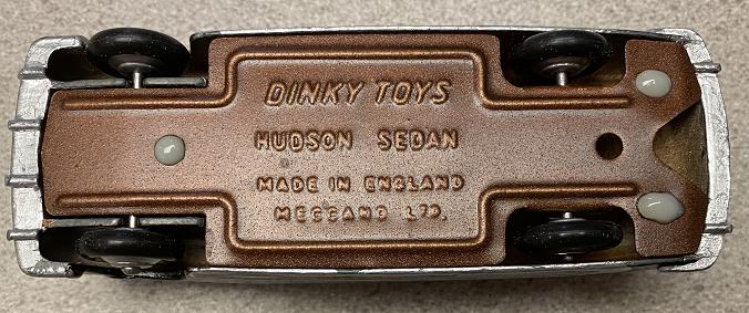

By the way, I do use resources from my dental office to help me with these projects. These are the materials and the equipment that I'm highly experienced with. I disassembled the model and removed the rounded end of the axles using a dental handpiece. I bonded the base back in place and placed a retentive blob on the axle end using dental composite resins.
hudson base.jpg (68.23 KiB) Viewed 2536 times
