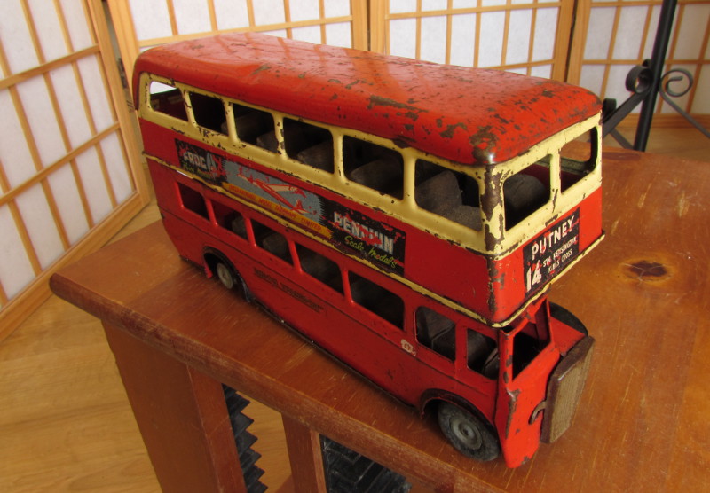

It looks like it's been stood on or stamped on:

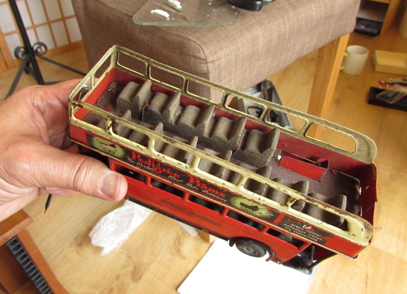

It was fun to open it up after 70 years or more:

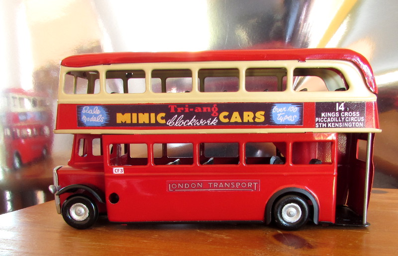

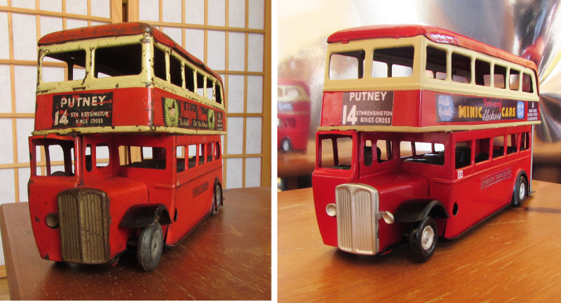

And compared to after:

Very nice rebuild although I am not so sure about the nearside headlamp, looks a little precarious so can you confirm it is actually secure.
Re: Triang Minic clockwork double decker bus 60M restoration
Small pieces of sheet metal can be very difficult to straighten. Get one part right and it warps somewhere else down the line. The process of stamping the original parts places all sorts of stress points and kinetic energy into the stuff. Trying to use fillers and putty to improve the look in some spots is just as difficult as the energy required to sand the areas can place enough force to deform other areas.  Some might think the time you put into this is an exaggeration, but anyone who takes on such a task will soon realize it's not.  You've done a fantastic job and the bus came out looking great!  From the body work to the paint work, all are very well done - a stellar job, you should be very proud of that restoration!

Ah you spotted the "droopy" headlight... It's superfine Milliput, and actually very hard, but brittle, so it should hold up well if not touched or knocked, otherwise a further rebuild will be required. And that's right about dealing with tinplate; because it's very thin I wrongly assumed it would be easy to manipulate but the more I messed with it the more difficult it was to get right. I read somewhere, maybe here, that the tabs can take 2 bends but no more, and that's exactly what happened. You can bend the tab to release a piece then bend it back to secure it again, but it it doesn't go right and you have to bend it again it immediately snaps.

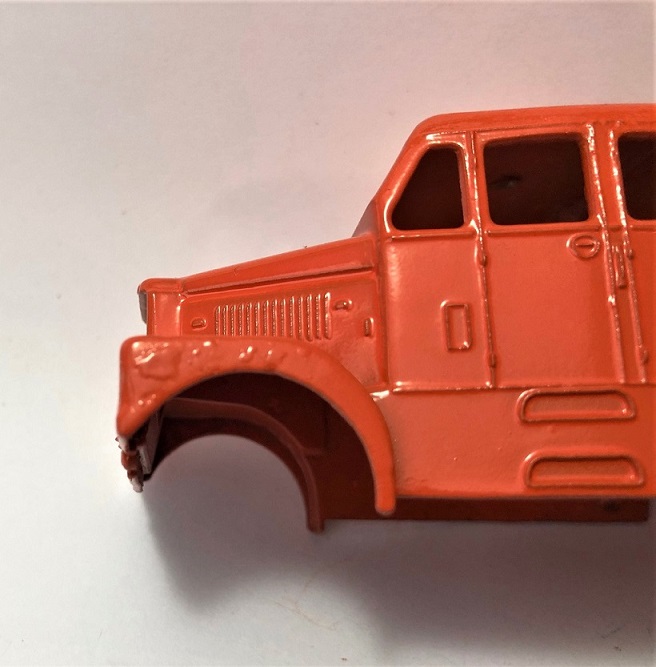

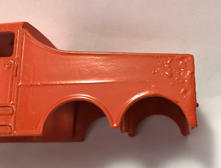

I recently started another K-8 restoration. It was another one with white rust and had some pretty deep pitting on the left side. I used filler putty on the left front fender and on the left rear side board. The front fender's putty bubbled and swelled in odd shapes. The rear sideboards putty swelled and raised the level enough to visually obscure some of the high lines and bubbled on top of that. Back into the stripper and starting all over again (sigh). Getting the putty work right was 90% of the prep for painting, that time is now wasted. I'm not sure what happened but I am going under the assumption that I painted too soon and the putty was still out-gassing and that's what caused the reaction. I'm switched back to an older favorite with regards to the putty and waiting a week from putty work to painting.
