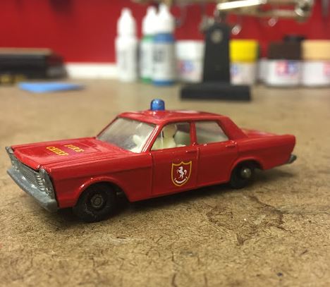

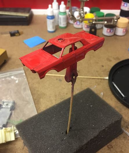

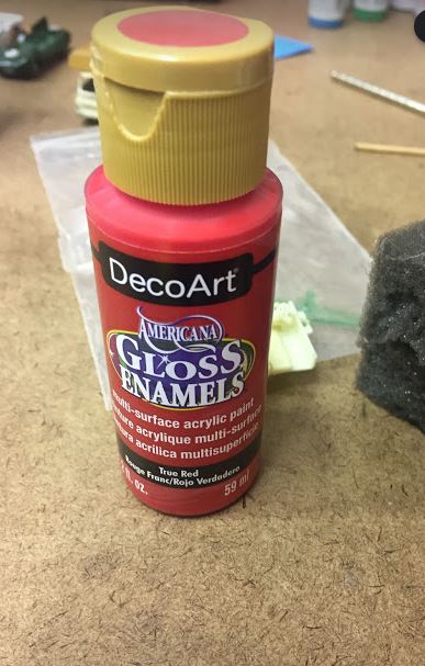

I'm always looking for ways to save on my hobby. I read an article in Railroad Model Craftsman about using common craft acrylic paint for model railroading and I tried it on a Matchbox. I used Americana Red, diluted 50/50 with alcohol, and added a few drops of Liquitex flow aid. The results came out nice for the Ford Galaxy. I have had success with red, and white paint. When I tried Americana Blue, the paint gelled when trying to dilute. It diluted better with water but was marginal and I wasn't happy with the results when spraying with the airbrush. The article was in June 2015 if anyone is interested. A friend gave me a copy.
I primed with Tamiya Primer, sprayed the red, then followed a coat of clear gloss for the top coat. The two ounce bottles are about $1.50, about one tenth that I can buy Tamiya paint for.

That looks like it turned out great! I have recently heard about using those types of paints as well, will have to give it a try.

Superb work..We like a bit of paint talk on here....I have been experimenting with Acrilics myself but the ones that come in match pots...Good thing is you can get paint matched and it dont cost the earth....B&Q in UK will even match off a sample and mix it there and then..You need a good size pattern though..Good luck welcome and good work.Ian.

Interesting subject... I've been researching craft paints on models for years now. I haven't really used them on my Matchboxes yet, though that may change sometime soon. In a nutshell, I've found that they work pretty good in a lot of cases, though maybe not every case. Really deep, rich, saturated blues and reds seem to be tough for craft paint. I also like student-grade tube acrylics, they can work well if thinned down, but they tend to be less able to cover completely without several coats. I make an acrylic thinner using Floetrol, water, and some Future acrylic floor polish that makes a nice airbrushing medium. I generally prefer Ceramcoat acrylics, though some of the others work quite well too, except maybe for the very cheapest brands. I have to use an airbrush to get good results, and they always need thinning as they're too goopy straight from the bottle. Windex works good as a cleaner, as well as window washing fluid from the auto parts store, which is mainly water and alcohol. Craft paint dries to a dead flat finish, which is great for models, but not so much for Matchbox cars, as they usually need a gloss coat. There are a few metallic craft paints as well as gloss mediums you can buy but I haven't tried them yet. Hope this helps
