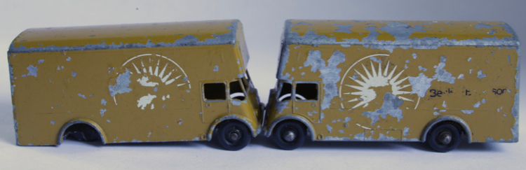

It's also clear that many were played with - my two, for example, which I think are real. They came in the same lot but had no provenance:
Beales Bealson
Beales Bealson
IMG_7298 (1).jpg (216.21 KiB) Viewed 3006 times
Perhaps we should work out how many we have between us? If we compared numbers to something equally distinctive and desirable (green Cadillac?), we might get at least an idea of how relatively common they are. I've got these two (and three green Cadillacs).
