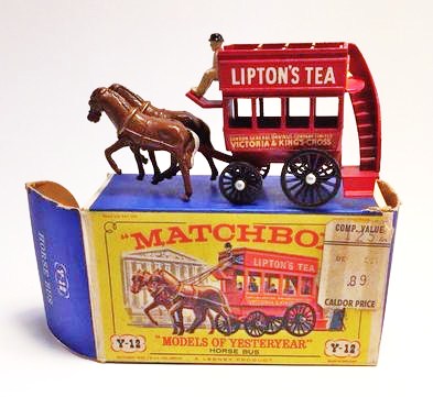

here is one to teach with..
have to grab photo before it drops off
https://www.ebay.com/itm/MATCHBOX-YESTE ... 663.l10137
box is already dried out with tag on face.....suggestions?

If it were mine I would be leaving it alone as the price label on that is part of the model's history and belongs with it.
It is very unlikely that label could be reomoved without causing some damage to the box ans I suspect it will have left a dark image underneath, a shadow or ghost image showing where the label was stuck to the surface and it can not be removed as it is embedded into the cards structure.
Best to soure another box without any retailer added labels.
