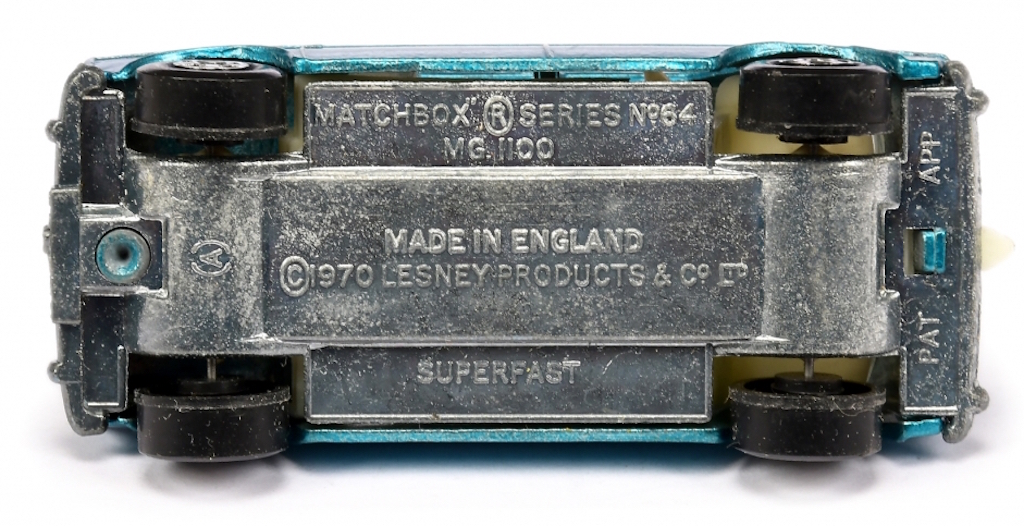

Ok lets have a look at this base to start, this must be glued or held together some other way.You can see straight past the front rivet and into the base.
no64
no64
No64 MG100.jpg (480.67 KiB) Viewed 1613 times

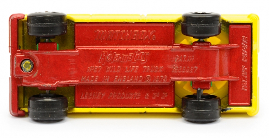

And this model with a hand punched base rivet by the factory?
no57
no57
Pictures from Vectis auctions .

Yes you are right the prepro models look ok, but I feel that some of the base painted models just do not look right.
I will do my best to highlight what I can.

What about the 2 models I have highlighted , I am sure that the prepro models and the Brazilian models are genuine.
But what about these coloured bases? Do these look genuine? Can any one enlighten me on a hand punched base rivet.
