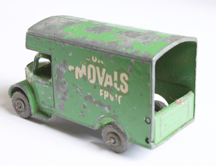

First, the casting line. It's usually quite difficult to see in photographs, but easy to spot in the hand. Here's a green 17a with the line. You can see it on the inside of the body just above the level of the tailgate. This is the very late casting without the window in the cab (that's my excuse for its terrible condition!).

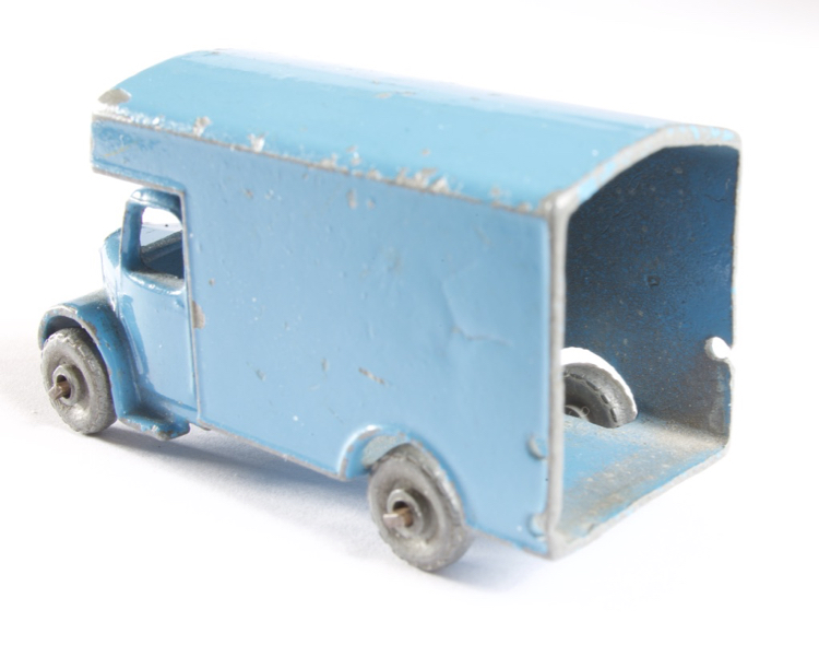

and here's the smooth wall of an early blue 17a. It's only the first blue models that are without the line.

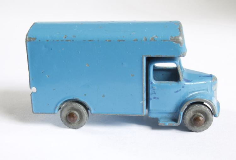

Now to the casting flaws. This one is without a tailgate and from the way this side was moulded, it's hard to imagine that it ever had one - surely it would have been loose in the box, even before anyone played with it?

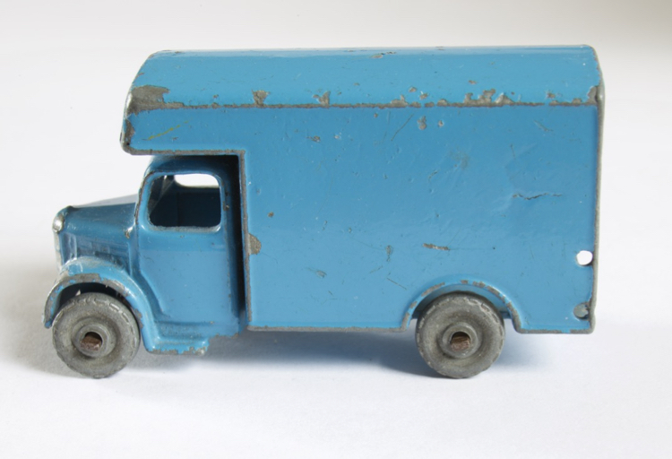

There's also a big flaw on the other side - the large crack in the metal towards the back

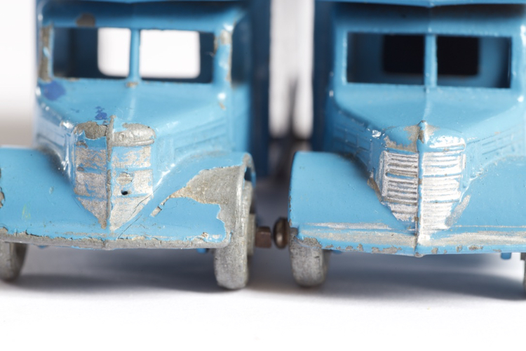

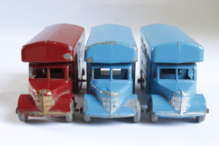

and a hole in the radiator casting.

The paint is very thick, which is why the grille looks so poor. I think it was probably just a bad day at the factory, but it's nice that it's survived so well.

It is possible that the casting flaws are indications that this is actually a trial, low-pressure test shot, designed to test the tooling before final hardening. The unusually thick paint could be seen as supporting evidence.
Re: 17a removals van casting line and flaws
Posted: Wed Nov 21, 2018 11:04 pm
I agree with Hugh as it simply has too many flaws to be allowed to go to retail. Full production models will very nearly have at least one small flaw which at an early stage would have been assessed as acceptable. Looking at a low presure casting they can see if any modifications are required or if the mould is fine and under normal presure would fill to an acceptable level.

Here's the front, with a comparison with another 17a, also without the casting line inside the body.

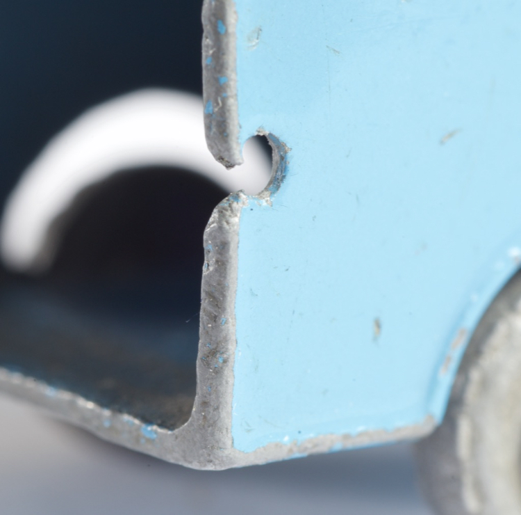

and the right side of the back, showing how poorly formed the hole was. If you look closely, you can see blue paint on the back next to the hole, showing it was painted like this, confirming that the casting was always incomplete.

DrJeep wrote:I wonder why the tailgate had three studs, and not two or four? Two would have allowed it to open: I'm sure that trying to open the tailgate must be the main reason so many are missing. Four would have much stronger.
I think for assembly purposes fitting two tail gate pins on one side and then forcing the single pin on the other would have been far easier and less breakages than trying to fit two on each side. There would have been a small amount of give in the van wall for top pin insertion but no flex in the bottom. Not sure how much flex there would have been on a newly cast tailgate without breaking pins.
With regard to the hinged tailgate, if this were hinged with two bottom pins a new design would have been needed or the pins would break after a while when the tailgate came into contact with van floor. A little like the 35a Marshall Box Mk7 where the door/ramp contacts the chassis and probably the model most often seen with a missing part. If it were hinged with two top pins like the 40a tipper it would not have been too good as a removal truck.
It is also interesting to note the later casting (green model above) also has a flaw on the lower left tailgate pin hole, I have seen a number of flaws on this model over the years with metal flow issues making it quite an interesting casting study. A wonderful and a tough little casting though.
