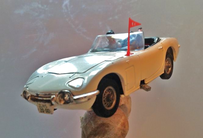

I have obtained a James Bond Toyota model. Unfortunately the lever that operates the boot lid is bent.
I'm not sure if it's possible to bend this back straight. I am worried that as it's cast it may break. Would some heat help? Hopefully I have attached a photo
Any help would be appreciated

Hello Foxy, welcome to the forum.
I have resized your image for easier viewing and added some brightness to the area you are asking about.
These items are usually made of a mazac (zamac), based material and it is possable some heat would enable this part to be bent up slightly to a better position. The drawback to this is that too much heat as if applied by direct flame onto the part for too long will just boil the metal into a useless blob!
If you are intending to do a light restoration on this model, my prefered method of making the lever more presentable is to use small modelling files and simply file it into a better looking shape doing away with heat completely.

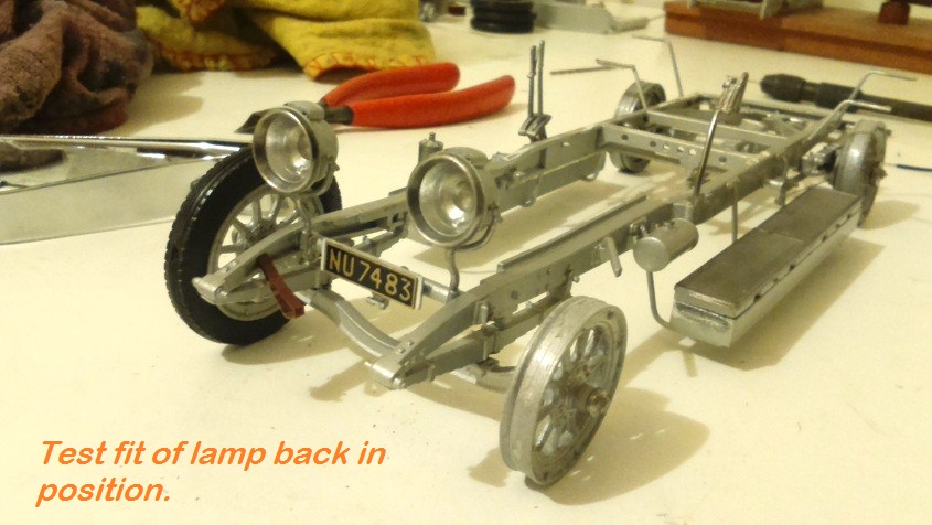

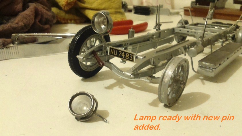

Shown below is a similar job descibed by ''SupraBob'' on a very thin so delicate headlamp bracket.
The drill held in a piece of blue wire insulation is resting in the hole.
The new pin (a piece of wire similar to fuse wire) is placed in a matching drilled hole in the headlamp's upright support.
Test fitting of lamp back onto it's original support. When ready this will simply require gluing.
