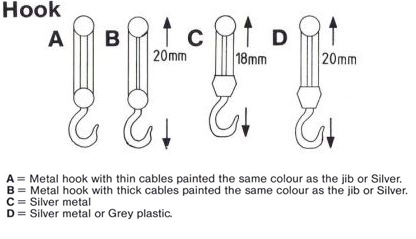

DrJeep wrote:Is this a thick hook? Yellowfoden says the thick hook is too late for the tan models.
Hi Glenn,
Just a note to clarify the thick hook terminology.
The thick hook shown on the USA sold model in 2 July 2018 (BST) has a round rope pulley block and thick ropes.
The hook shown on the marktplaats model has the 6 sided rope pulley block and is even later again in production in terms of the 30b. It does have the type 1 jib from what I can see but the painting of this style hook is inconsistent with what we know of timelines so far. The unpainted hexagonal metal hook came in at Stannard code 11 or Jones code 12 for the 30b. Neither the 18mm or 20mm hexagonal have been catalogued as painted on the 30b.
I prefer to use Stannard hook codes because Nick does not differentiate between round and hexagonal rope pulley blocks and it is very easy to incorrectly code the 30b if one goes by thick 20mm hook description alone.
Briefly the metal hooks should be described as 20mm thin round, 20mm thick round,18mm hexagonal, 20mm hexagonal.
Then there are the plastic hooks.
Please find attached line drawings as how Stannard describes the hooks.
This hopefully will aid other collectors with some of the finer points of 1-75 variations.
Bert
M.J. Stannard hook types for 30b
Stannard hook types.jpg (45.01 KiB) Viewed 2489 times
Re: Yet another tan & orange 30b crane!
Marktplaats model detail.
So this is the later (Hexagonal) block.

yellowfoden wrote:the metal hooks should be described as 20mm thin round, 20mm thick round,18mm hexagonal, 20mm hexagonal.
Thanks, Bert - that really helps me understand the 30b much better. Even though I had my own silver-bodied round-hooked model on my desk, I didn't notice the difference in the shape of the pulley block! So wrong hook, no silver trim, proud ejector ring. I wouldn't be bidding.
