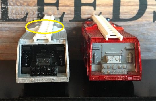

I would consider it to be a too late a casting to have that type of RW baseplate. The ladder securing module on the top looks to be of the angled design which if it is, will also confirm the late casting and it seems the model is pretending to be one of these below...

It's certainly not an early casting, which wouldn't have the sill or the flat area for the sticker. From the back view, the black plastic looks like it could be painted over silver. I don't think I'd buy it.

...and as I suspected, the ladder securing module on top, is of the angled design a definite later casting.
late casting.JPG (61.54 KiB) Viewed 2209 times
My highlight around the modules clearly showing the later angled design. This model is not worth a penny!

Very much a home brew, everything is wrong about it. The base shot earlier is not the best but the rivet area looks strange as well.
