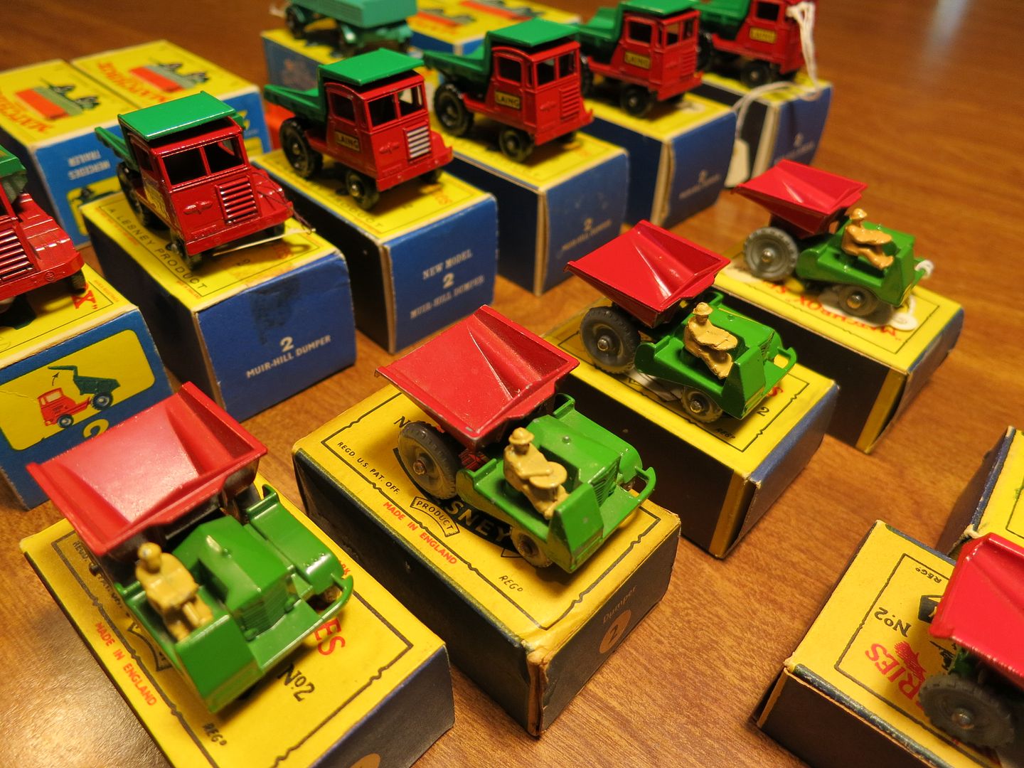

Greetings, I have attached a photo (compliments of a good friend and fellow collector) that shows the driver without a hat as well as the driver with the "V" shape hands. It is my understanding that the model shown from his collection with the hatless driver actually was purchased from the collection of Bob Brennen! Hope you enjoy:kwakers wrote: Bob Brennen in his 1973 NAMC Guide had a model in his own collection that had the later Light GPW version listed as his Code D with a driver without a hat. Bob was a purist just as Rob, so it may be interesting to see if any other collectors have seen that version through the years. I have not ever found one, and I realize the drivers can be easily switched (Therefore not worth cataloging). Could they have used a different driver for the last castings of this model to be used up? Just a thought....Kwakers
Bill
DurangoKid

Re: 2b Site Dumper
The angle of the steering column is all wrong Joe. I have a #39A Ford Zodiac with a driver who has an odd hat on him. I have a feeling this man is in fact a 2B Driver, and the one seen in this 2B is in fact an original hatless 39A Ford Zodiac Driver.
I must admit that Bill's collector friend has answered a 43 year old question I have had on this code in Bob's NAMC Guide. As I head off to bed now this is like a belated Christmas present for me Bill. Please Thank that friend twice for me if he is the one who supplied the 6C pictures as well. From your group picture of these models he is a fellow detailist who should join our friendly Forum just for fun. I am sure you have invited him on, but even if he lurks here for a while he might not be able to fight the urge to join and comment once in a while...... I hope he will....
