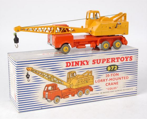

Now i piced up a set of DT 972 Lorry mounted cranes. See pictures:
Image Image.
As can be seen the arm of the crane is broken. Is this repairable? Can i use a two component glue? Can it be soldered?
I would like to learne something about this.

GiVa wrote:As can be seen the arm of the crane is broken. Is this repairable? Can i use a two component glue? Can it be soldered?
Not being able to see yor image yet, I googled the model which shows this one...
Model number 972..JPG (56.08 KiB) Viewed 3334 times
I don't have this myself but maybe another member does and can advise you to a repair.

Thanks to the moderator for helping me out so far. Inclosed i send some clarifying pictures.
The problem is the arm of the crane. It has completely broken off the hinge. Now i am not going to drive it around the carpet, but it must be able to take some strength.
What will be the best repair method?
