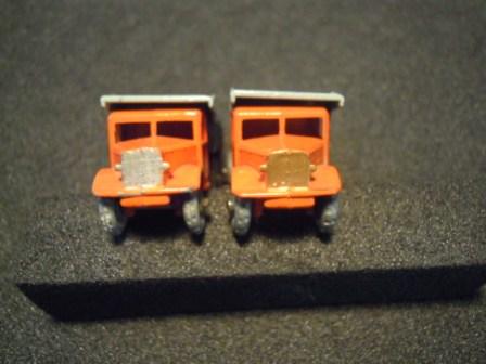

Both Kwakers and I have Nick's variation code 1 with silver trim (thereby meeting Martin's Maxim) and this should therefore be regarded as a new variation.

My 6a with silver trim:
6a-1 (small).jpg (15.52 KiB) Viewed 2403 times

I can confirm the silver trim variation also.

The silver-trimmed 6a is not silver over gold, making it highly probable that the silver is factory applied.

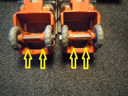

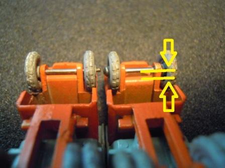

A small summary. Body variation, front axle brace:
a) long brace, small gap
b) short brace, large gap

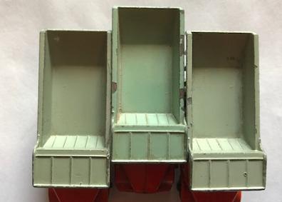

a) small corners inside the engine are curved
b) larger corners inside the engine are angeled

The trim could be (I am not sure about the variation "c", I need the confirmation of the second model ):
a) HA silver trim to radiator grille, two triangle brace, tank
b) HA gold trim to radiator grille, two triangle brace, tank
c) HA gold trim to radiator grille, two triangle brace
d) HA gold trim to radiator grille

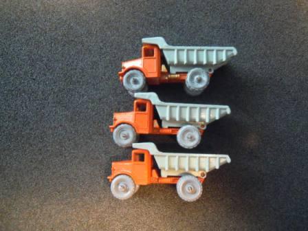

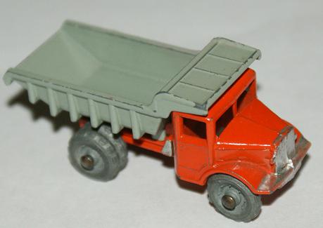

Here's a 6a with a grey/blue tipper I've had it since the 1980s. (Not the World's best photograph for which my apologies. If you're struggling, it's the one in the middle!) I don't think it's a sunfade because the cab is still the original bright orange. The colour does remind me of the elusive duck egg blue Y6a Osram lorry. Does anyone else have one?
Blue tipper (small).jpg (21.75 KiB) Viewed 2380 times

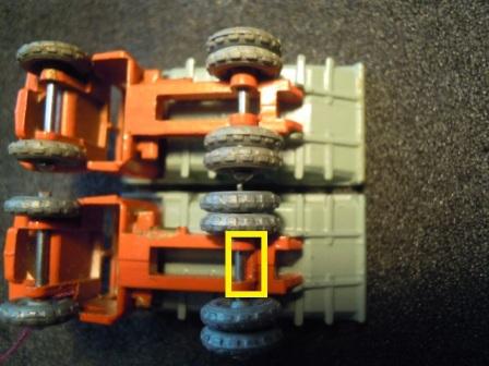

There is a strange variation, the mold was gradually destroyed and created an additional brace behind the rear axle.
