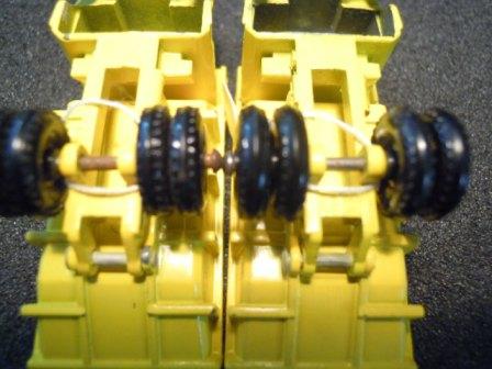

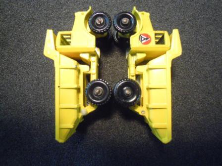

A small summary. There are some unlisted variations. The rear wheels could be:
a) BPW ø12 x 30
b) BPW ø12,5 x 30
a) BPW ø12 x 30
b) BPW ø12,5 x 30
- DSCN6120a.JPG (29.35 KiB) Viewed 2484 times
- DSCN6121a.JPG (30.92 KiB) Viewed 2484 times

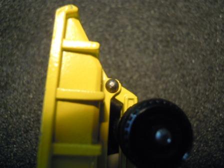

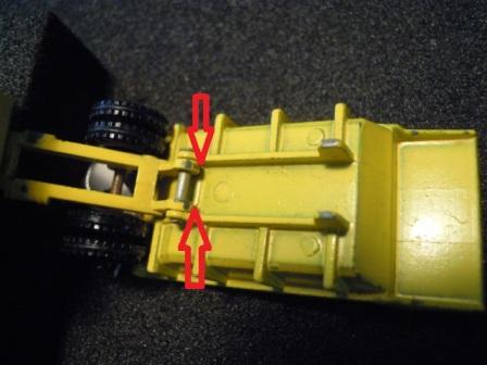

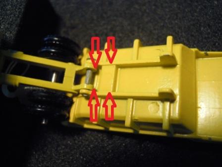

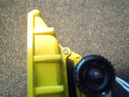

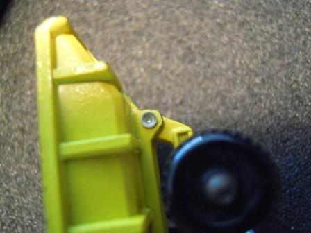

the bucket hinge (strange, but I am still looking for dome head crimped rivet. Have anyone seen it?):
a) biff rivet round riveted
b) biff rivet chisel riveted
c) dome head rounded rivet
some biff rivets have a small yellow shade
- DSCN6128.JPG (20.99 KiB) Viewed 2477 times
- DSCN6127.JPG (22.46 KiB) Viewed 2477 times
- DSCN6123a.JPG (20.27 KiB) Viewed 2477 times

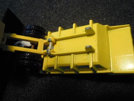

Re: 6b Euclid Quarry Truck

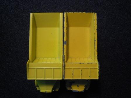

Tipper:
a) without any brace
b) with pin brace, without cross brace
c) with pin brace, with cross brace
- DSCN6124a.JPG (20.91 KiB) Viewed 2483 times
- DSCN6125a.JPG (24.1 KiB) Viewed 2483 times
- DSCN6126a.JPG (21.24 KiB) Viewed 2483 times

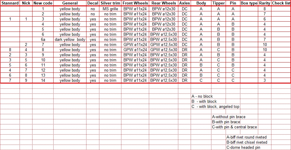

A proposal of a new list. Please comments.
- 6b Euclid Quarry Truck .jpg (295.09 KiB) Viewed 2469 times
- Posts: 626
- Location: Aust
Hello Antonin and Hugh,Diecast wrote:A proposal of a new list. Please comments.
My own version of the 6b with NO decals match the variation details as Antonin has stated.
I have also observed over the years we have had six members show their no decal variation.
I have yet to add the silver grille variation to my fleet. I have only ever found versions that I believed were hand trimmed which included some fine trim to the lights and bumper
In your proposed listing I note the MS silver trim model you list with NO decal. In the past we have seen Greg (about May 2012) show an example but this was WITH decals.
Bert
Hello Antonin , my one with Silver trim radiator has a chiseled end Biff rivet and has decals the one with-out decals has the Biff rivet riveted.
